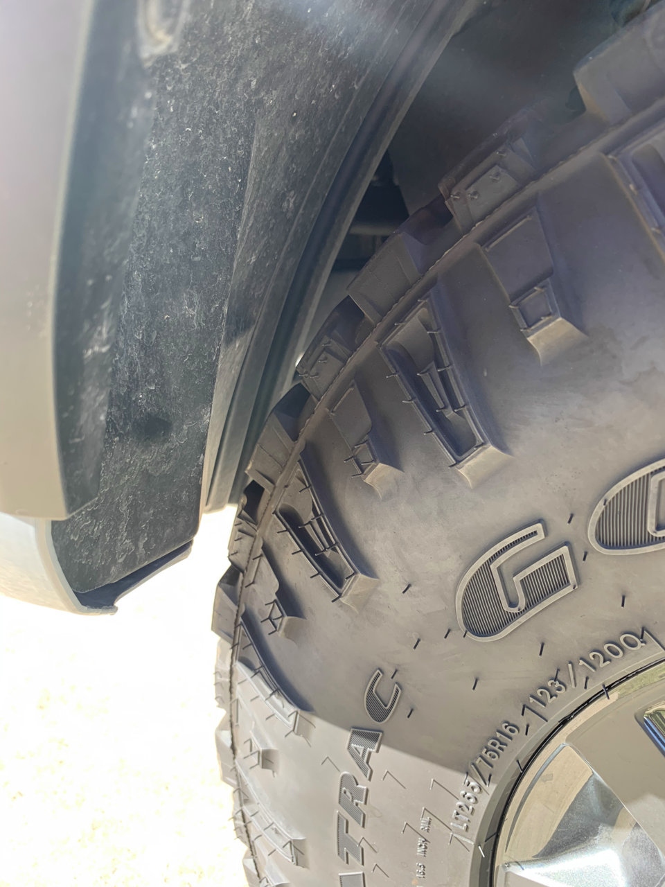

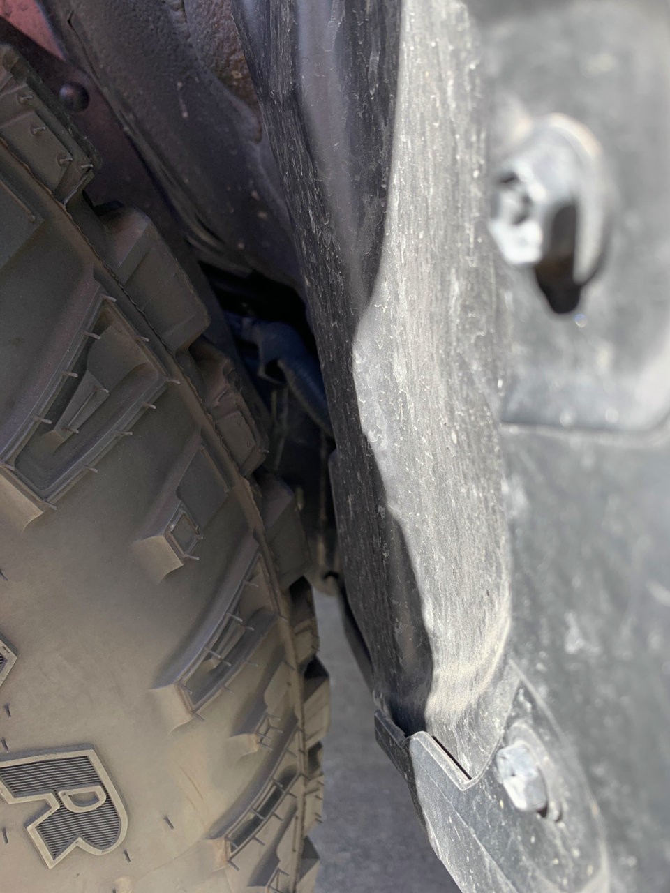

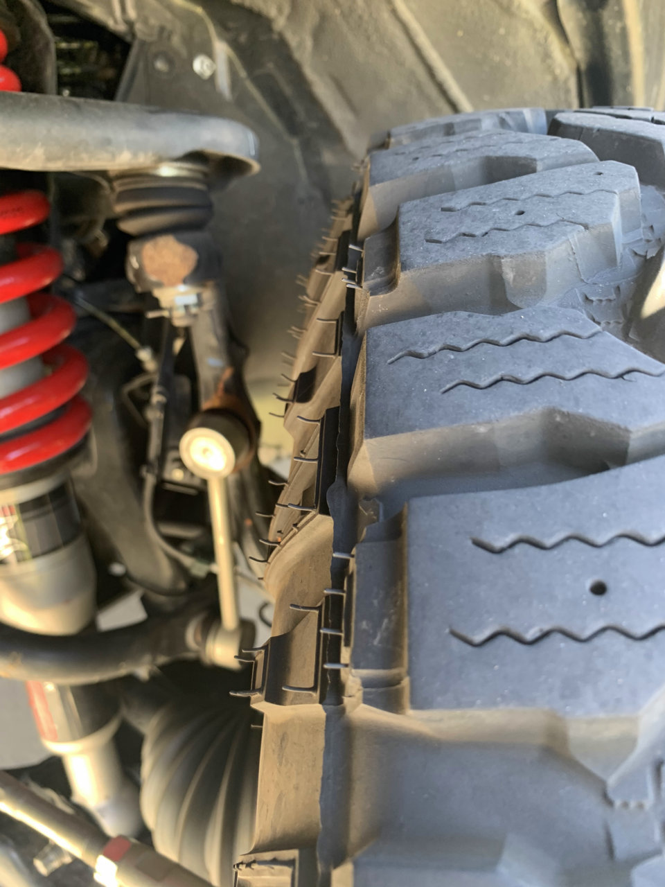

    TRD Pro suspension with Headstrong 3 Leaf AAL, DV8 OR front slimline bumper & Engine Skid Plate, RCI OR high clearance bumper, CaliRaised Trail Edition Sliders, Spidertrax 1.25" Wheel Spacers, 265/75 16 GY Duratracs, wrapped the OEM wheels, OR Roof Rack, Extang Exceed Hard top Tri fold tonneau.
    I have 265/75r16's on OEM TRD-OR Wheels with 1.25" Spidertrax spacers, and the clearance is very close with the rear wheel well, UCAs have no issues. 285's will be much closer and would likely require trimming of the wheel wells.
