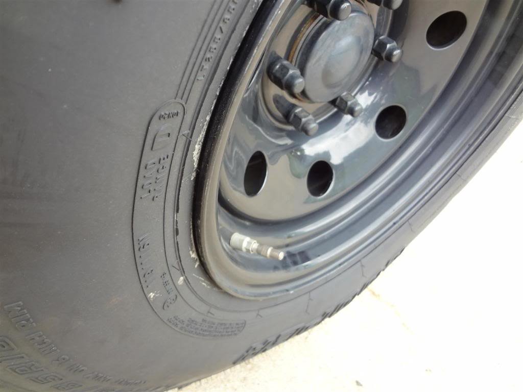

    Some problems with 255s on 8" wheels (not enough wheel protection)

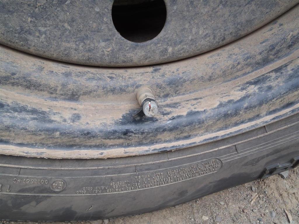

    You can do that to just about any wheel you want depending on how hard you go. I've rashed just about every wheel I've owned, both with 265 and 285. I also sheared a valve stem off once when running the 285s.
