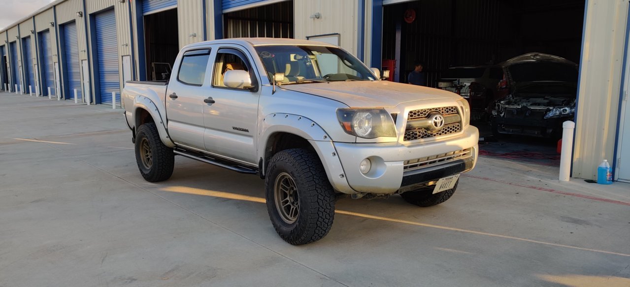

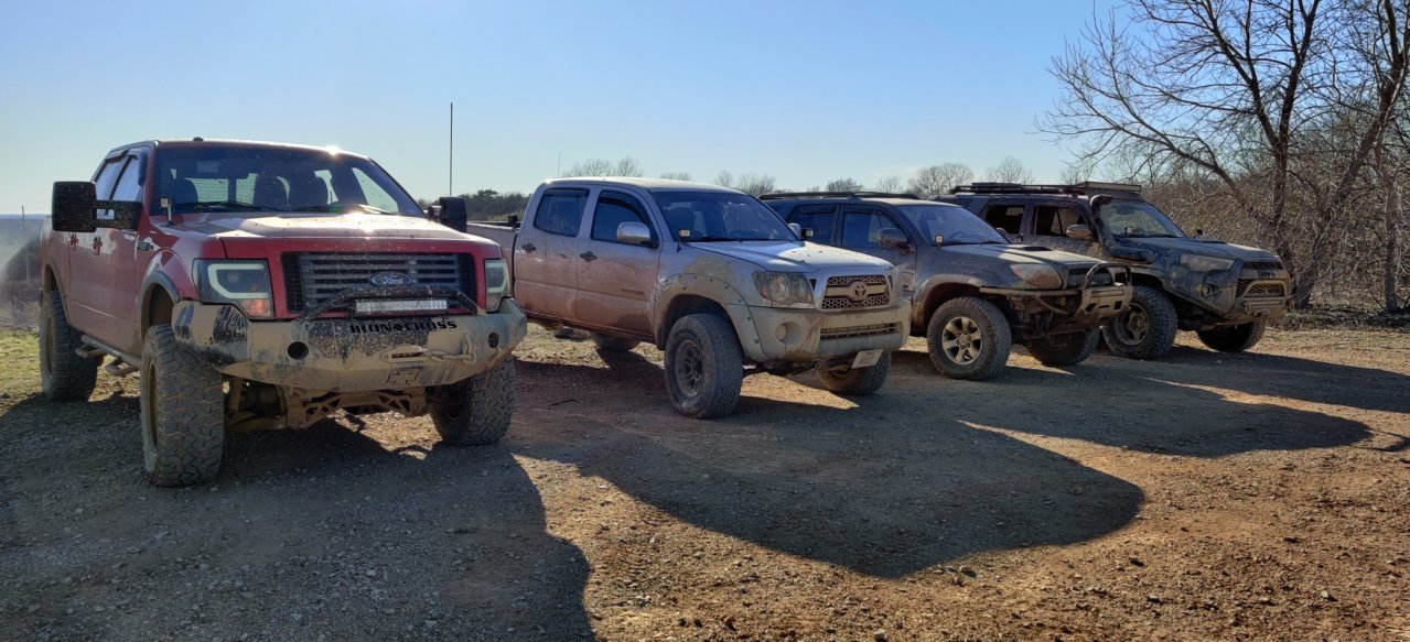

    Current state:
    11/26/23

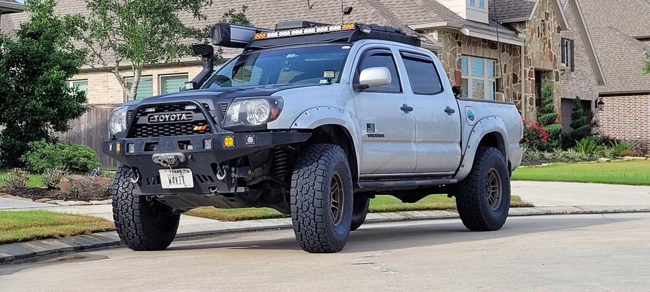

    Long story. Flipped it and swapped cab. Lots of mods + supercharger since then. Front end swap with custom retrofitted morimoto d2s 5.0 and tid bits. Fiberglass and lt in the works. 4x4 transmission upgrades and twin stick about to be installed. Rough current progress.

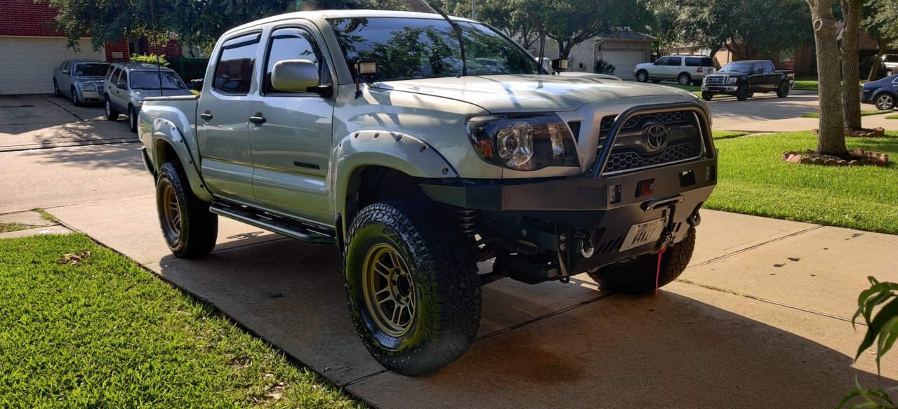

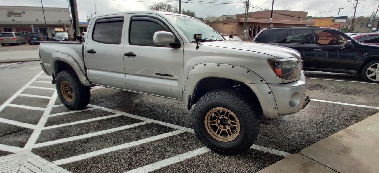

    5/22/2021
    35's, FJ t-case, Lights, URD LT Spec-U Headers, some other shenanigans. lots of stuff installed and/or laying around

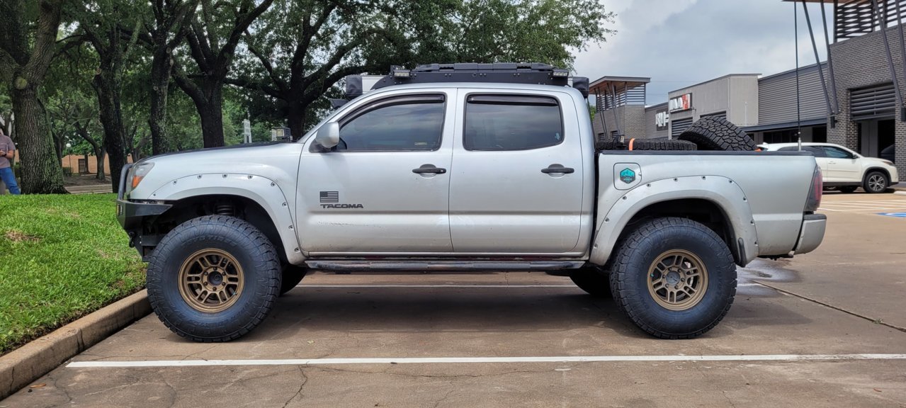

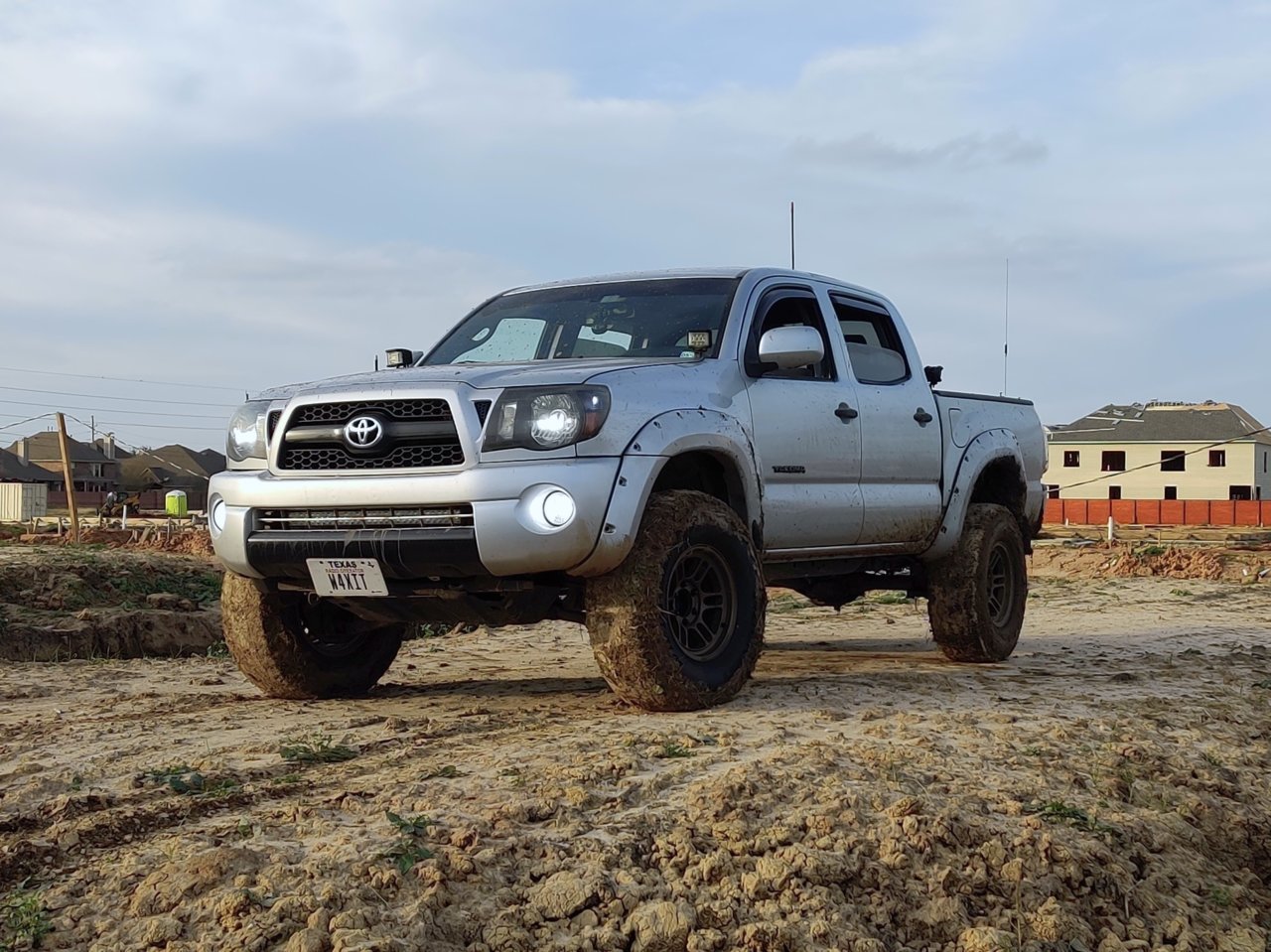

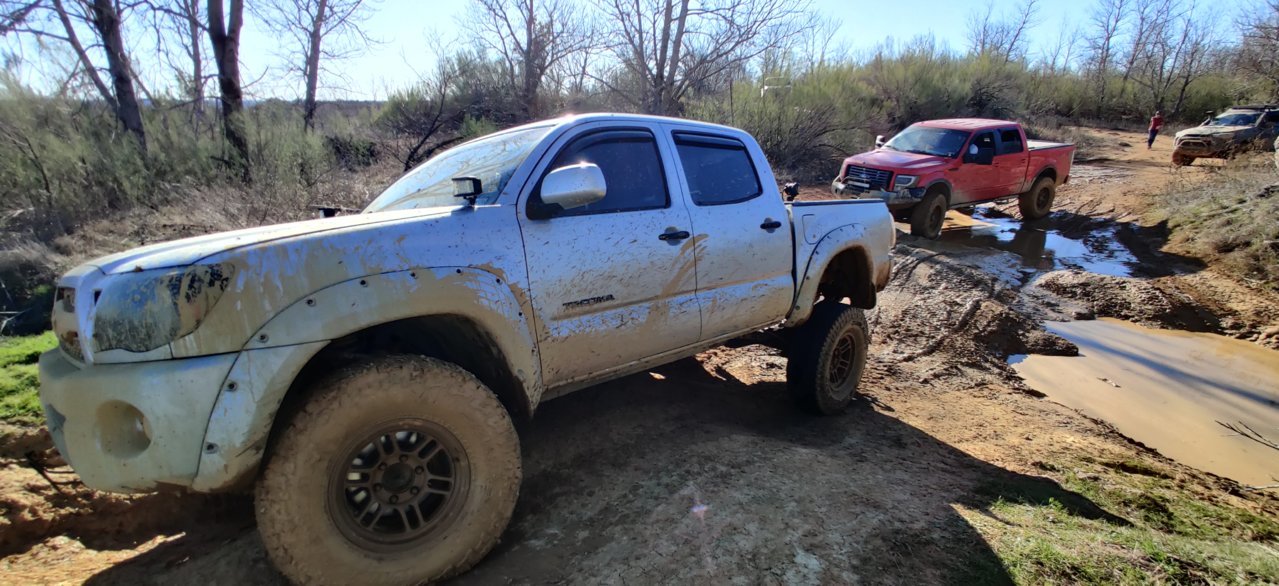

    As of 7/29/2020
    Lots of water in headlight, excuse the haziness. It clears up in a day

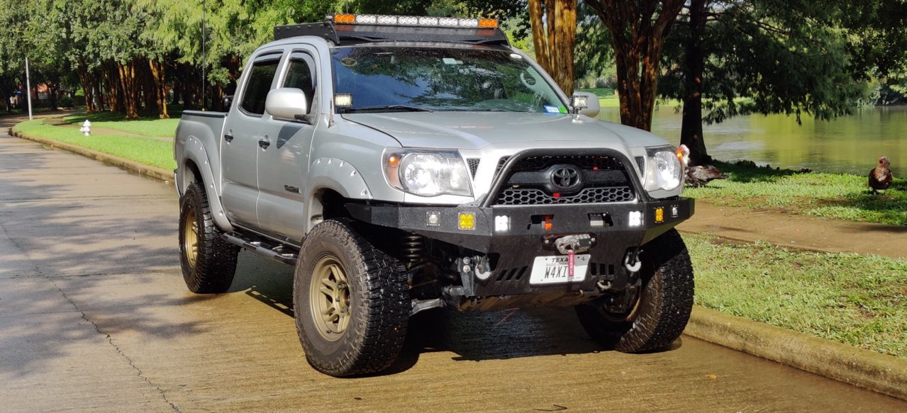

    Armor:
    Victory 4x4 sliders
    Beaver tail hitch
    Coastal Offroad High Clearance bumper (90hrs welding)

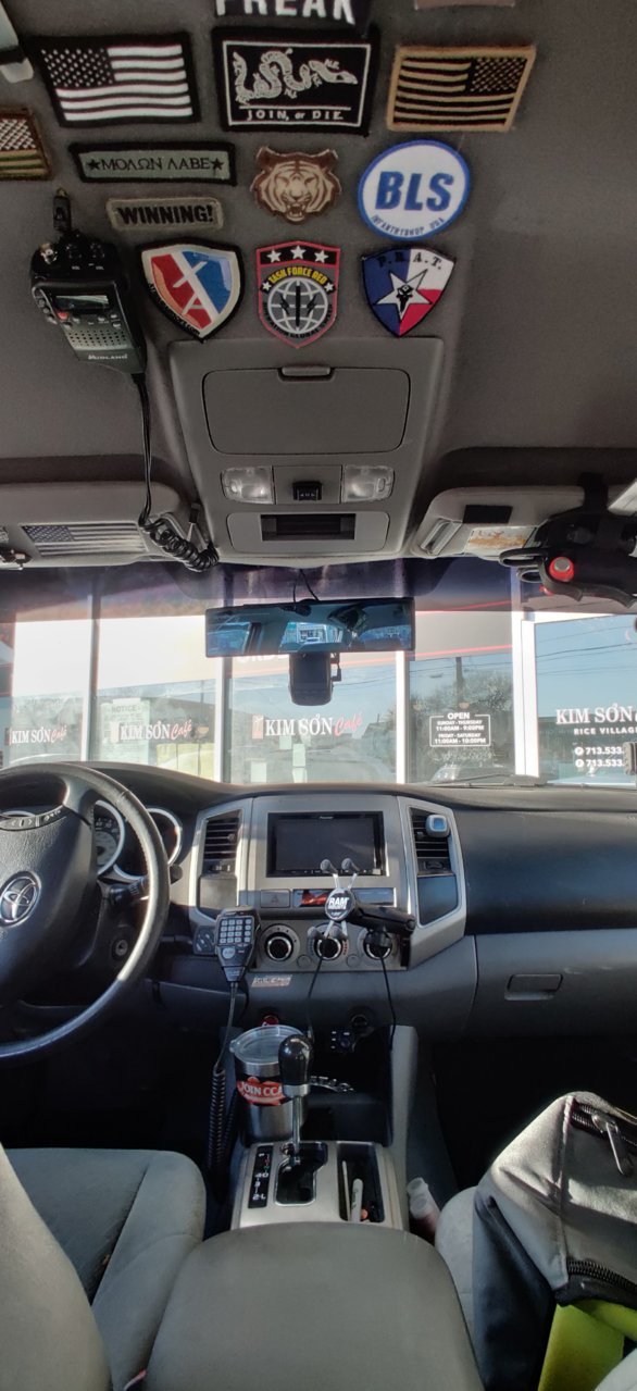

    Interior:
    Pioneer AVIC Z150BH headunit
    MESO upper molle rack
    Ballsout off-road mounts with RAM and custom scosche mount for radios
    Scangauge 3d printed housing & Scangauge II w/ custom Xgauge configs
    Broadway Wide rear view mirror
    Upper windshield tint

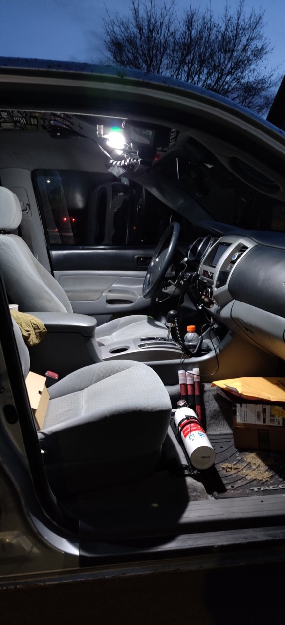

    Passenger seat mounted fire extinguisher
    Passenger mounted road flares
    IFAK/emergency gear mounted on molle panel
    Cam lock center console
    Dome light on when doors open mod
    Motorized rear slider window
    Discreet pistol and rifle mounts

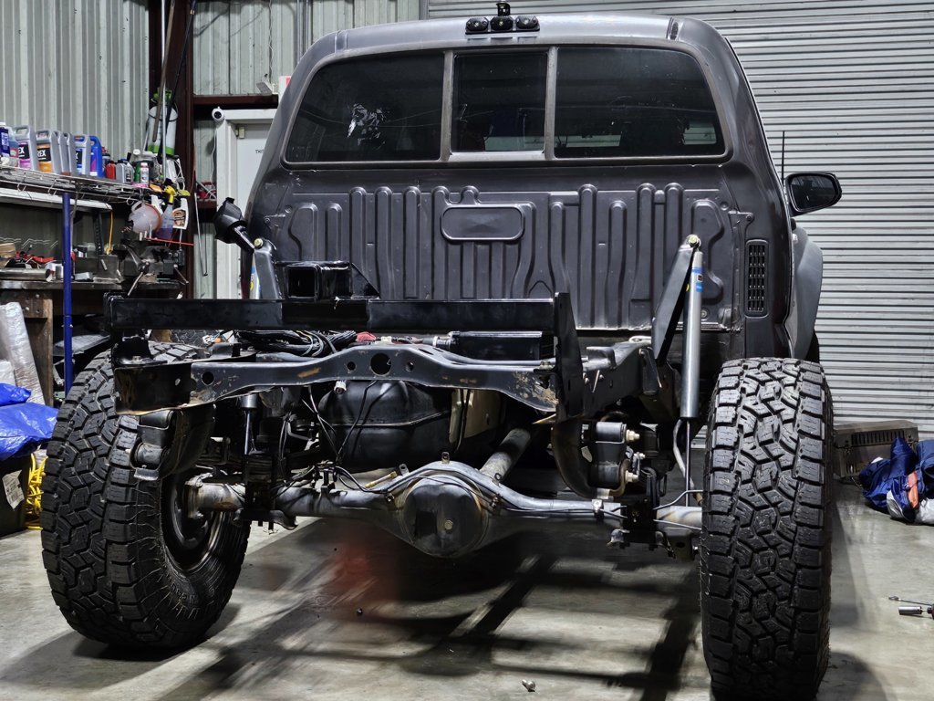

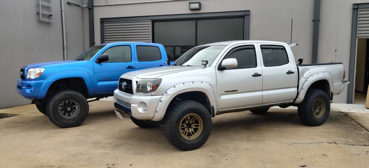

    Added a picture of the current status.
    Alot of parts and fabrication added in the last few months. Will update with a narrative soon!

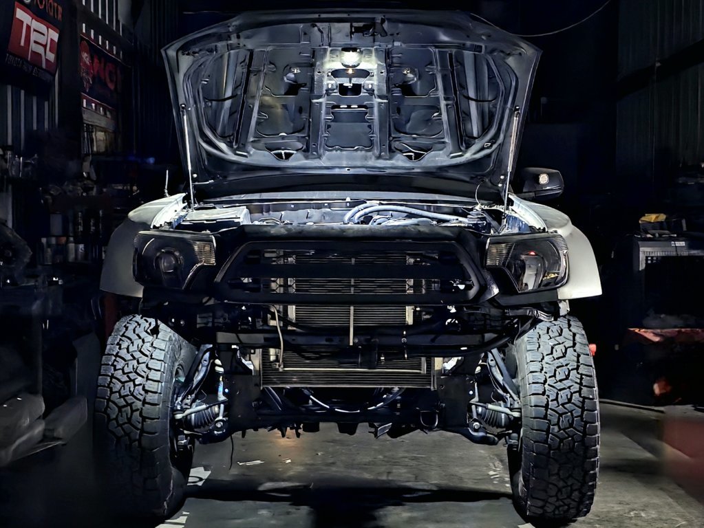

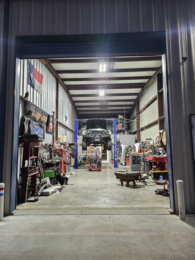

    One year update since the last pic of November last year... lol
    Steves104x4 likes this.

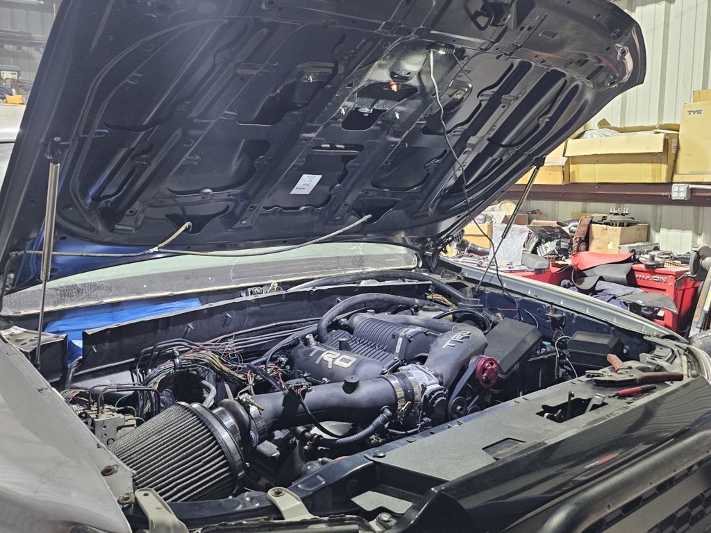

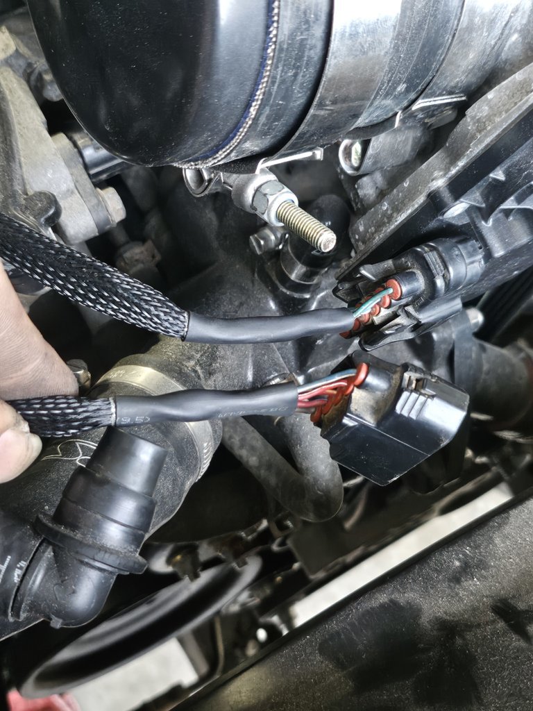

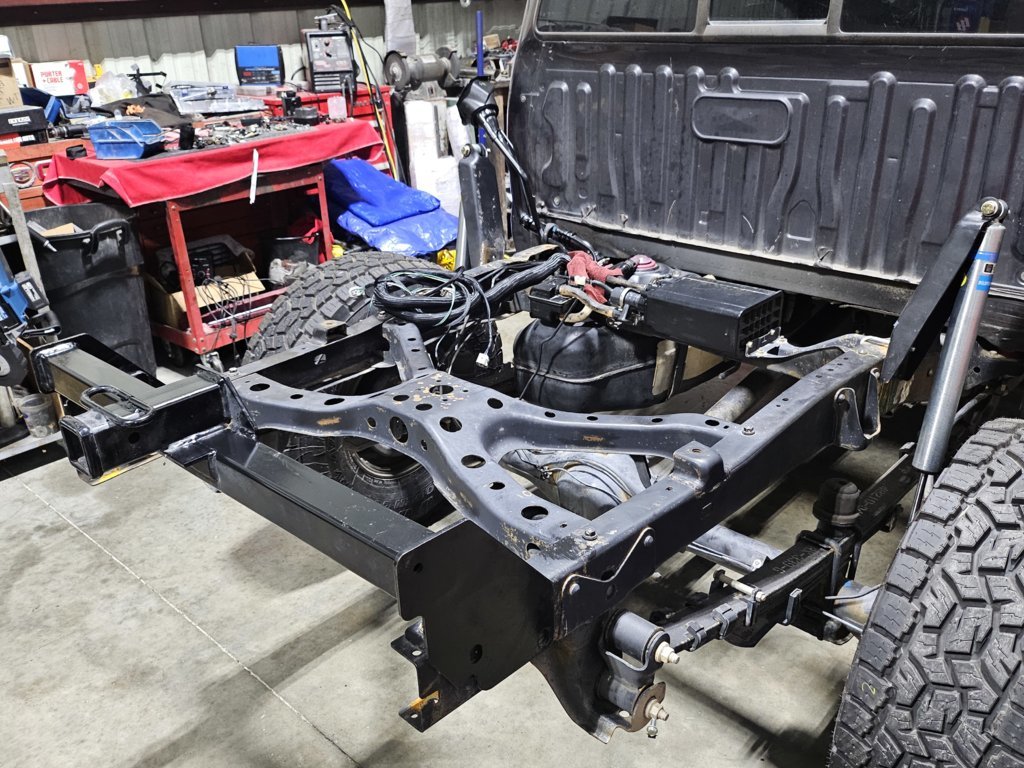

    Got both rear shocks relocated, cleaned up rear frame in regards to chassis and electrical.
    Started wire tucking the engine bays. De pinning, heat shrinking and applying FR braided loom where applicable.
    Received many aluminum and steel tanks to replace the PS reservoir, SC reservoir, windshield washer fluid.
    Began rerouting sc lines out of engine bays for an overall cleaner aesthetic.
    Alot of small things happening everyday with this damn thing and also finding issues as I go. Thankfully I keep it in the shop garage at all times so it's been a joy to work on it, even if in small 10 minute increments throughout the day. 20241127_180353.jpg 20241227_191346.jpg 20241227_191038.jpg

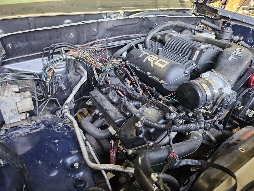

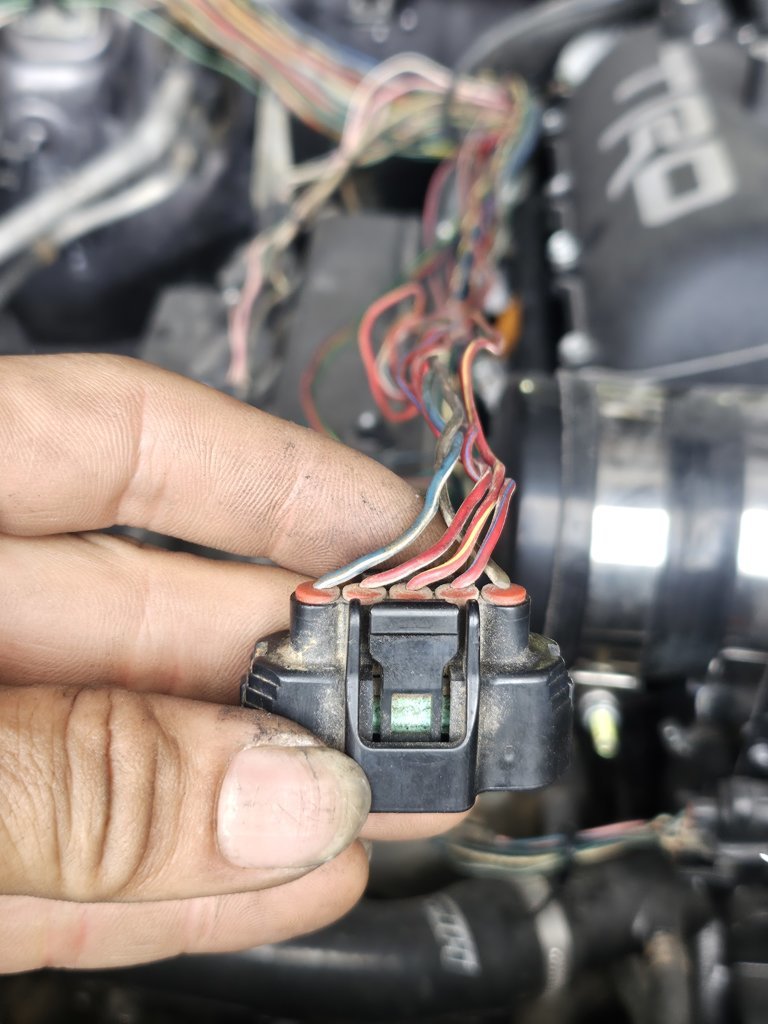

    Ripped out all the oem wire loom, opened a ridiculous can of worms. Wire tucking to rerouting.. I wasn't happy with how much I've beat up on the truck in the last few years and decided it was time to clean it all up the way I wanted. 20241117_171601.jpg 20241117_155014.jpg 20241117_171630.jpg

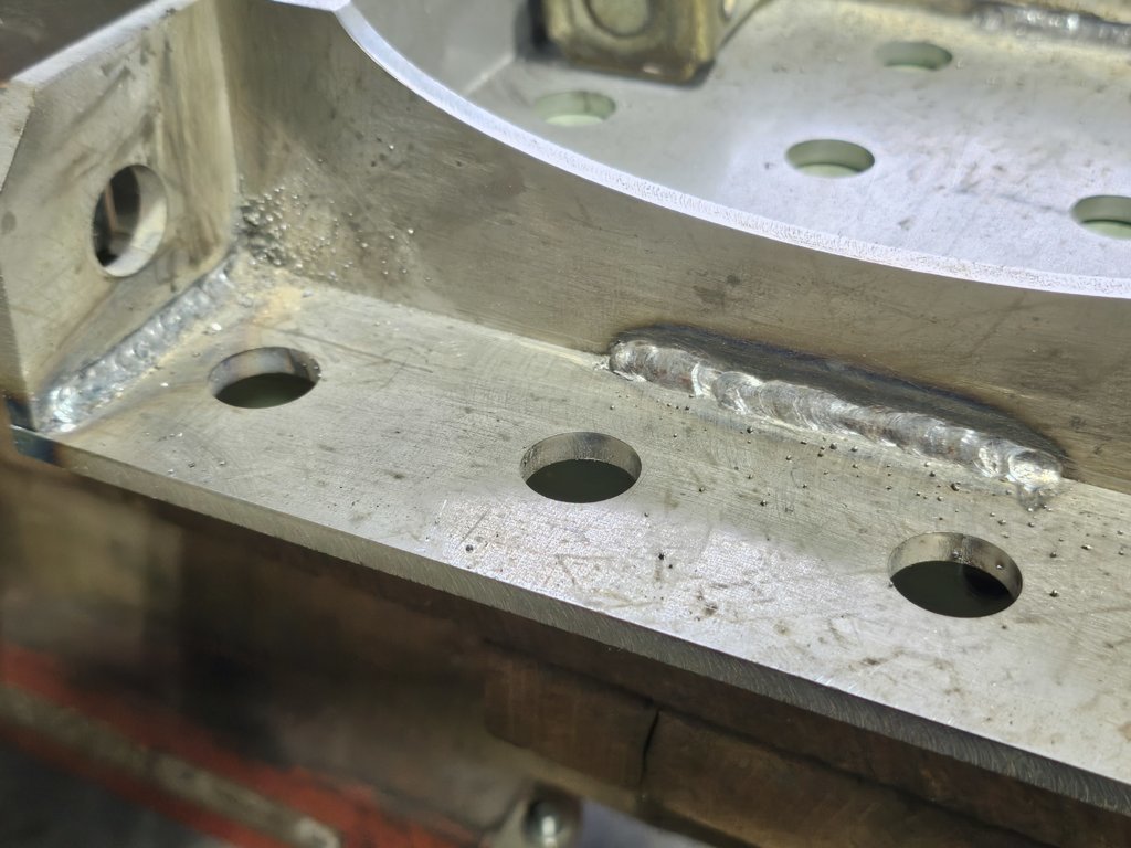

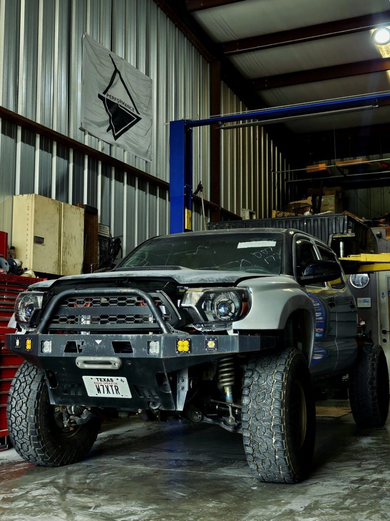

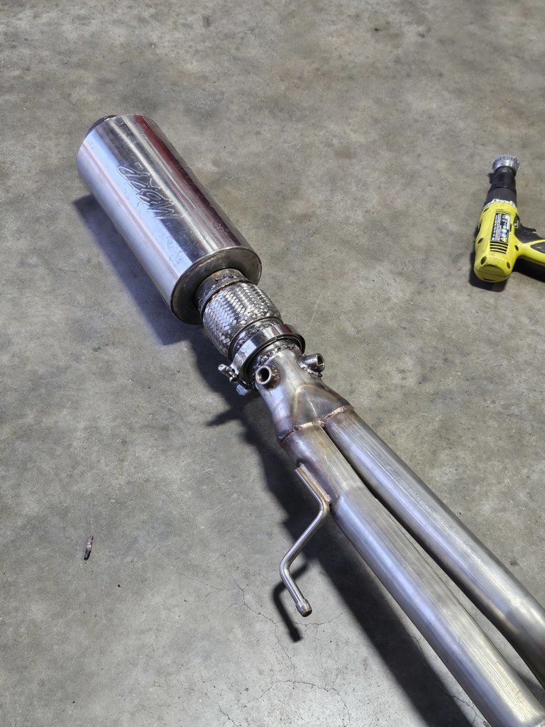

    The most recent picture from a few days ago. So much progress since. I actually had the truck stuck on the lift for almost 2 weeks which is unheard of as I go through 4-6 cars a day on average. The holidays really slowed down this year. Thankful though.
    Prepping the exhaust in this picture and just doing some welding practice to get back into it before my chevy 63 shackles install, front shock gussets, dirt king rear frame plate kit and finalize rear shock location and placement
    I got too lazy to get gas to tig or even a meh mig with the ss and tried ss wire in .035 in FCAW with 120v. I wanted to throw up. Serves me right. Going to reweld the exhaust later on.
    Deleted the donut and went band to 2 3" mbrp resonator and a borla xs pro
    First few passes on 3/8 mild with e71t .035. Dialed in a bit and did a little weld fixture table from TMR
