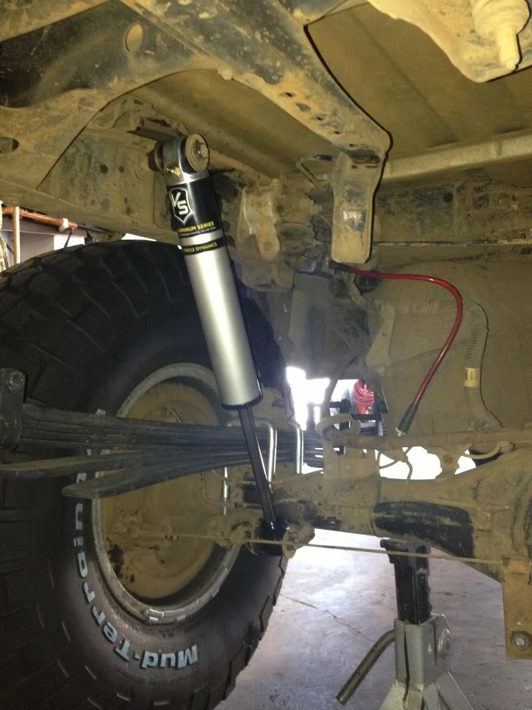

    i got the icons in installed them today. they were built for 2.5 inches of lift. and are freaking amazing!!! compared to the harsh ass stock shocks ride lol. it literally floats over the bumps great shocks!!
    1099B51F-274E-4987-BE15-AF2A6D4AD31D-133_3864b1013cf7bddbd57683e78b0cb211a14d01fa.jpg
