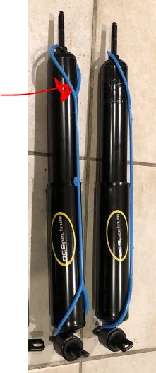

    First things I decided to tackle were the front shock absorbers. I got a pair of the KYB Gas-a-adjusts and had at it. I drove to a local autoparts store (in case I would need anything) and got to work. Three hours later I drove home, passenger side untouched and drivers' side fitted with a new shock absorber, but not a functioning one :frusty:
    The problem is the shock absorber hangs lower than where the bottom two bolts screw in. The how-to videos I found had the absorber being pushed up using one's hand, but these Gas-adjusts are DAMN stiff. I struggled for at least an hour and a half before finally giving up. I even tried setting a jack stand under and lowering my truck to compress it. No luck.
    Any tips or advice for getting these dang things on?

    Yeah, they are really stiff. I tried to use the jack to jack up the shock but then I couldn't get the bolts in to bolt the shock down! I ended up compressing the shocks on the garage floor then strapping them down in the compressed position - see example pic below (internet pic). I bolted in the bottom of the shock, cut the cord and quickly guided the top of the shaft through the mounting hole at the top. It took several attempts... Don't forget to put the washer and bushing on before you cut it!
    Be sure to use cording strong enough to hold them. I used the plasticky cord stuff that they give you when you buy a Christmas tree.

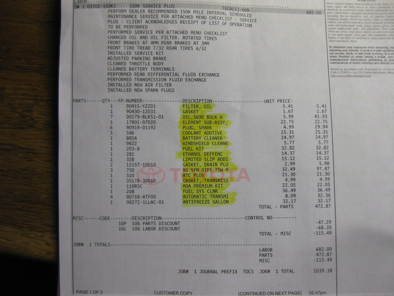

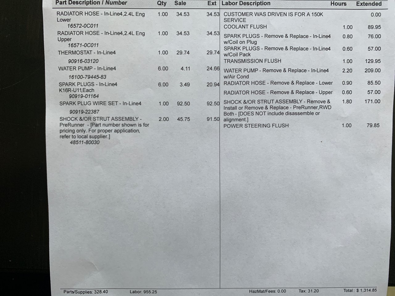

    I did my 150,000 mile service in January at 139,000 miles. Mine's the v6 and here's what they did for $1079 (including $40 tax) they omitted coolant flush in the job list but they did do it.

    lucky you NO 4wd service!
    did the battery service include new little pads, i think their purpose is to absorb moisture :notsure: prevent terminal corrosion
    also, did you get new tires since this invoice, they appear to be getting a bit worn at 6/32 tread on the rear
    i am probably going to get timing belt service at my trucks 150k in about 20k more miles

    Funny you mention using your jack. That was my idea for this morning :D
    I'll see what I can do about finding a strap of some sort to secure. Thank you

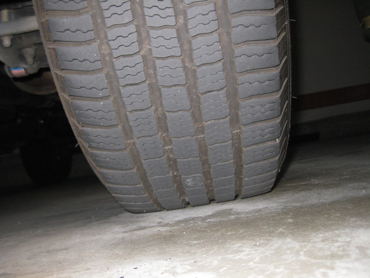

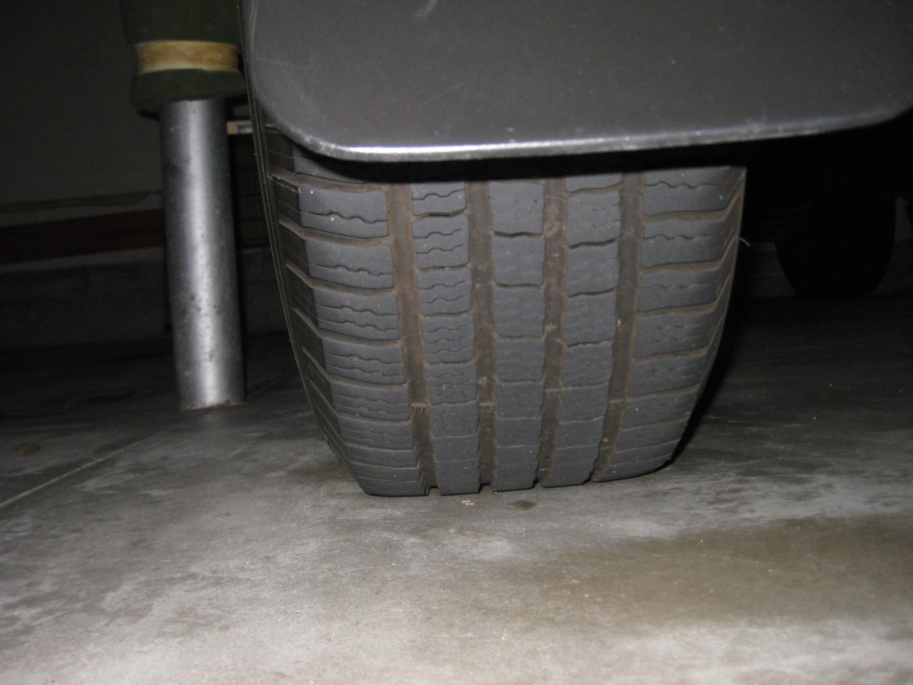

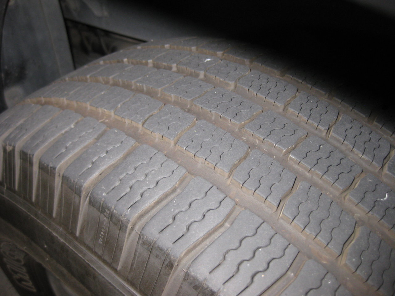

    Yeah they put those battery pads. The tires are still in really good shape though. I have the truck out so I went and shot pics for you of the rears. What do you think?
    Right rear
    left rear
    GQ7227[QUOTED] likes this.

    I use the dealer with the belief and faith that I'm getting Toyota-best plus my disability limits what I can do physically to my vehicles. Your guy didn't even offer rear end, coolant, tranny flushes nor even throttle body cleaning (big one to me). Seems to me he offered things he felt were needed specifically rather than a straight 150,000 mile "service".

    those are probably the 2nd set you have had (including originals?)
    the card that DT gives me when they rotate them show the minimum before the 'cautious area' to be at 5/32"
    if you don't regularly drive on wet slippery surfaces you can probably go further down than that without issues
    nice tires for these trucks can be the big bill :spending:

    Third set because the original set of (hard to recall the model-I think BF Goodrich All-Terrain TAs) wore down to shit in about 22,000 miles and were a nightmare in rain-just awful.
    I think I have a LOT of good miles left on these tires-they still cut right through heavy water stuff like freeway cross-streams like butter. Never floated not once. Plus my Lexus is almost due for its first set of replacement tires so I'm going for those first.

    I used the old bottle jack to compress and managed to thread a bolt in. Tightened that one bolt enough that it would hold, pulled the bottle jack out and proceeded to thread and tighten the second bolt. Same thing on the other side.
    New front shock absorbers are IN!:headbang:
    Also got a new pair of tires on the front. Alignment had been off (like this \ / couldn't tell cause it drove straight) and the inner tire was down to the wire (literally).
    Feels good :D

    Congrats! I didn't think of the bottle jack!
