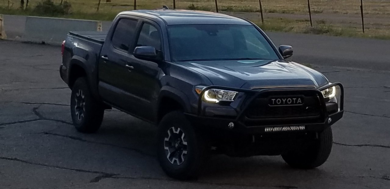

    Please help! Has anyone put a 265/75R16 on a Method 305 NV Wheel? biggest part of this question is: have you done it on a stock suspension?? any advice, wanna know if I can clear them Thanks in advance cuz I'm stumped on this one...Screenshot_20191113-165846_Gallery.jpg

    What's the size and offset of said wheels?

    • Wheel Size: 16x8
    • Bolt Pattern: 6 on 5.5
    • Offset: 0
    • Backspace: 4.5
    • Hub Bore: 108
    • Wheel Weight: 22.9

    I know that size tire will fit on the stock wheel but the method pokes a bit more...

    also I have a high clearance front bumper so no need to trim there just worried about the pinch weld on the frame

    You will be fine with that wheel & tire size. Might have to trim a little plastic where mudflaps would mount.

    yeah I'm not worried about trimming there just don't wanna do the CMC until lift after this winter... I'm in Montana and need to get rid of thos stock Prius tires stat hah!

    I've never seen a 265 rub on the cab mount, it's 285's that do that.
    The worst you'll see with a 265 is the mud flaps or tiny bit of plastic on the front if the offset is way off.
    I'd recommend a 17" method, it leaves you open to more tire choices if you do decide to go 33" later on.

    You'll probably rub in the mud flaps if you have them, but that's it. I have the same tire size with Method Standards (same width and offset as the NV's).
