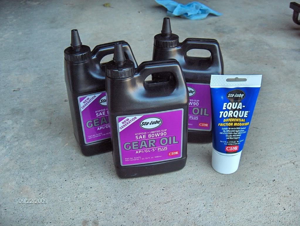

    Well, changed it out with this stuff:
    Seems to be a little better now after driving it about 10 miles on some curvy roads by my house. Still got it to chatter once at low speed, and then once back home I pulled it in the garage, jacked it up and did the trick with the rear tires. I can get it to chatter, but once again it does seem a bit better. Hopefully it just takes a little time to wear in to the clutches in the LSD and then goes away entirely. My rear diff seems to be getting pretty warm though. At about 70* outside it got quite warm just from the 10 mile drive I did, I can still hold my hands on it, but it was pretty warm. This all seem normal?
