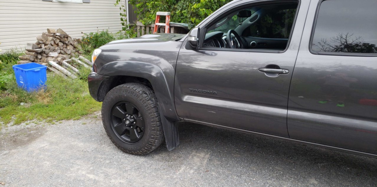

    I managed to get a good price on a used set of Goodyear Mud tires sized 255/75/17(factory Jeep tire), they slightly rub on mine with a 3" lift. Whenever I've been flexed and turning to lock there's a moment of rub but I trimmed my mud flap and it's been fine. The tires were at 90% tread left(near new) when I bought them.

    I just trimmed the flaps and it seems to be fine now.
