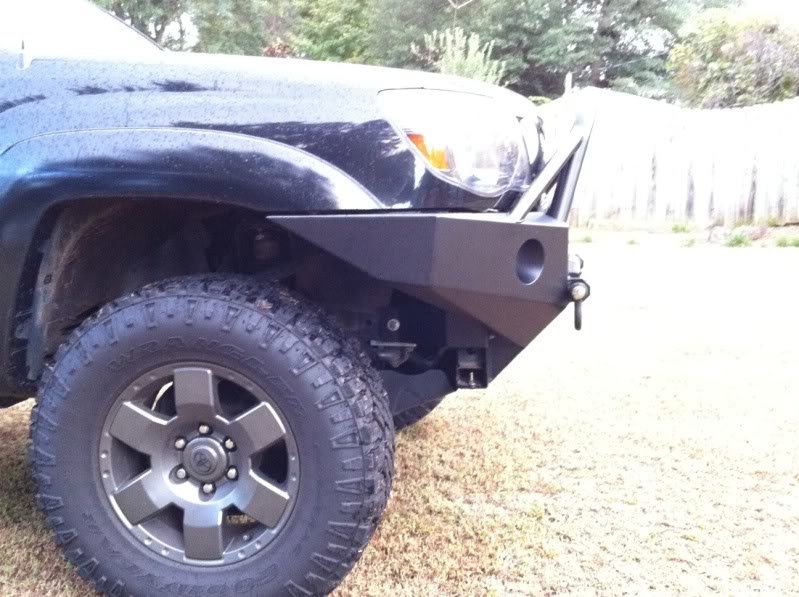

    Most plate bumpers use additional attachment points. All-Pro's classic bumper puts two 1/2" bolts in the front crossmember. All-Pro's Apex bumper has extra brackets that tie into the sway bar bolts. Relentless and ATO have tabs that tie into frame holes further back.
    As far as I can tell, only Demello uses just the 6 studs.
    Relentless:

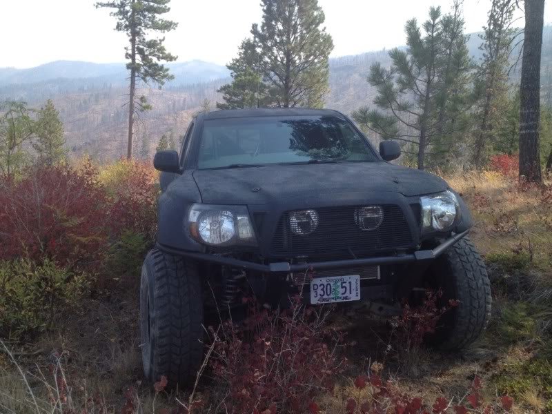

    Yes, yes it will rip off if you stress it. I don't even winch off of mine, mostly built for impact, but I welded a chunk of 4" angle iron between the frame rails. It also helps protect the radiator. I also took a 2" holesaw through the end of the frame and drove 4' chunks of DOM inside of the frame and welded it wherever I could. An engine cage helps increase strength too. Any fabricator can gusset it up in a few hours and make the bumper the strongest part of the whole truck. These frames are pretty weak, and with stress they crack pretty easy. Personally, I think the plate bumpers are worthless. Sure, the bumper won't bend, but the frame it is attached to will. I like the minimalist approach best.

    So if you hit something lower than that top bar it's gonna completely fubar your radiator? Looks a little bare down low

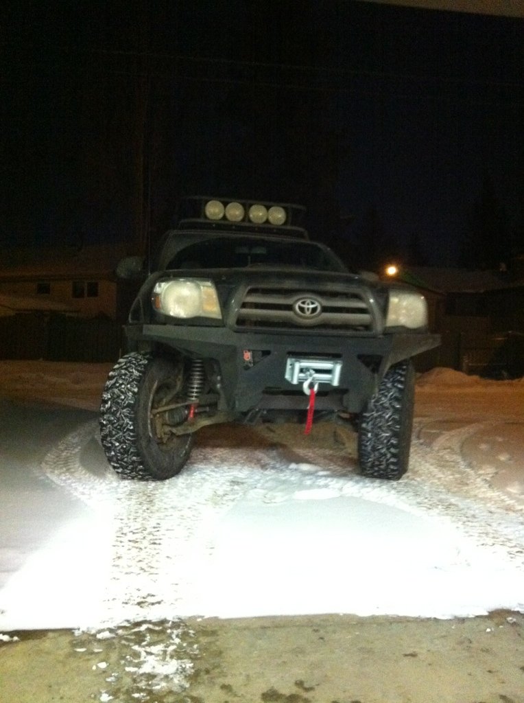

    Mine bolts on with the 6 bolts plus two by the tow hooks, I have only used it a few times but no problems yet, I will be making brackets to reinforce the sides
