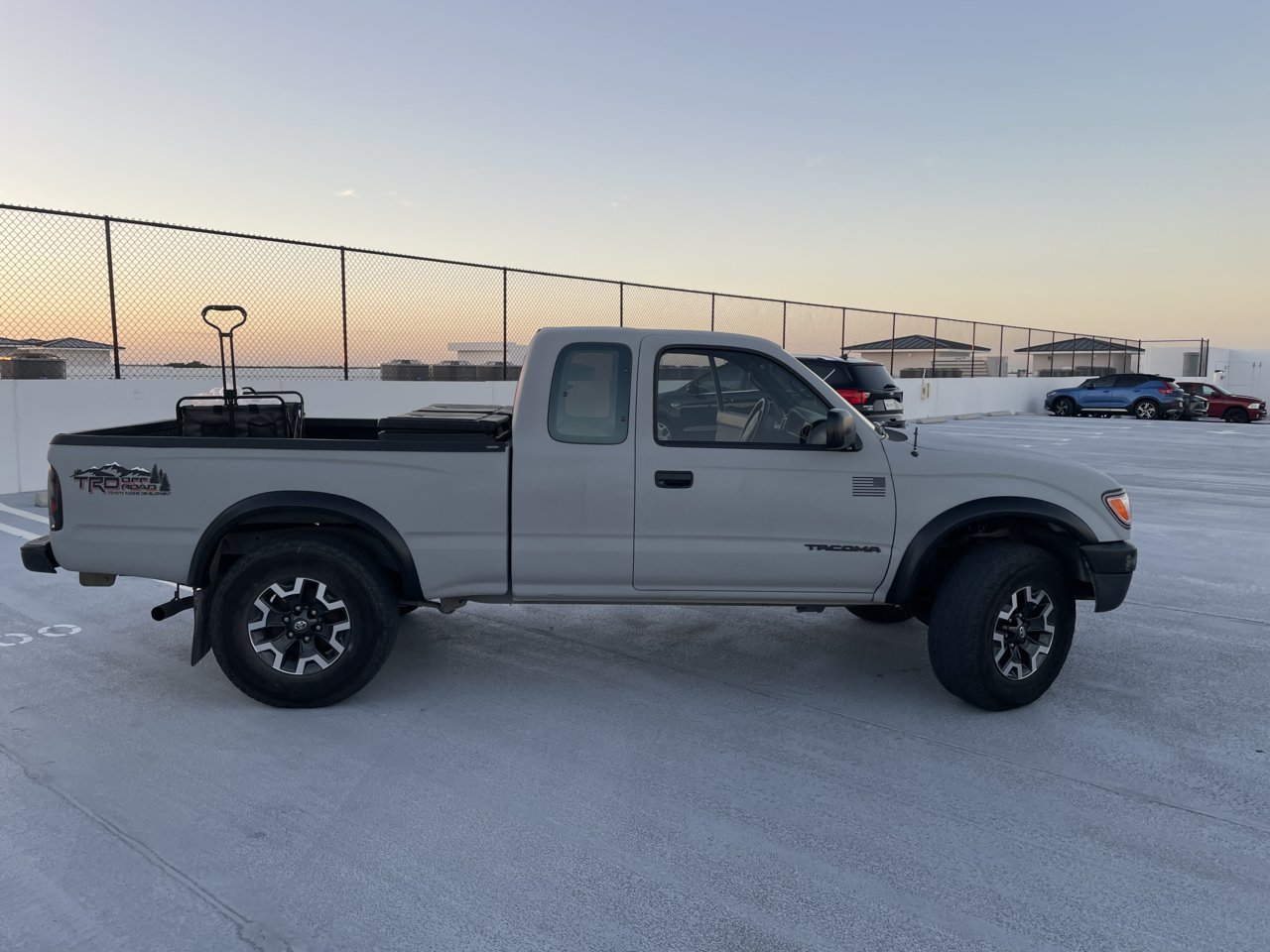

    Here are TRD Off-road that I dropped into my ‘95 4WD. They fit great. No lift.
    boston23 likes this.

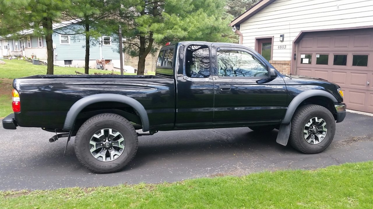

    Yes.
    Bivouac15, SkiBum95 and boston23 like this.
