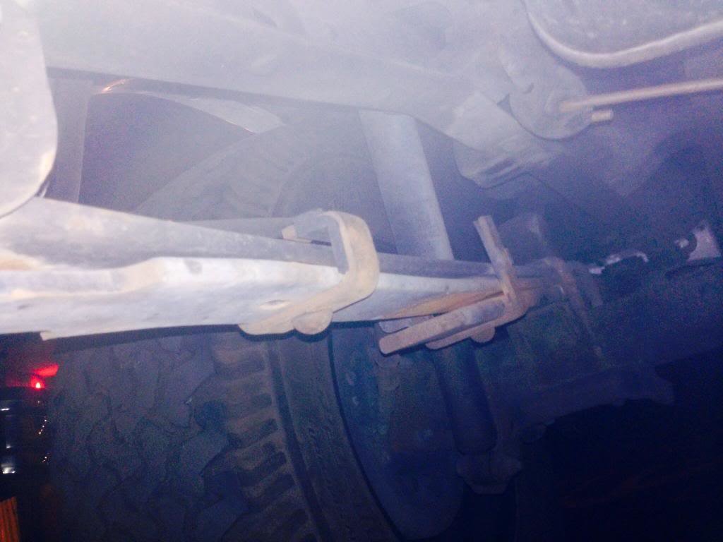

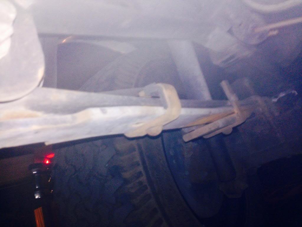

    How much of a lift you'll get out of them depends on how much yours is currently sagging. Best way to find out would be to measure from the center of the rear wheel straight up to the bottom of the bottom of the wheel well on yours and compare that measurement to a new truck. The difference is pretty much how much lift you'll get out of the new leaf pack.

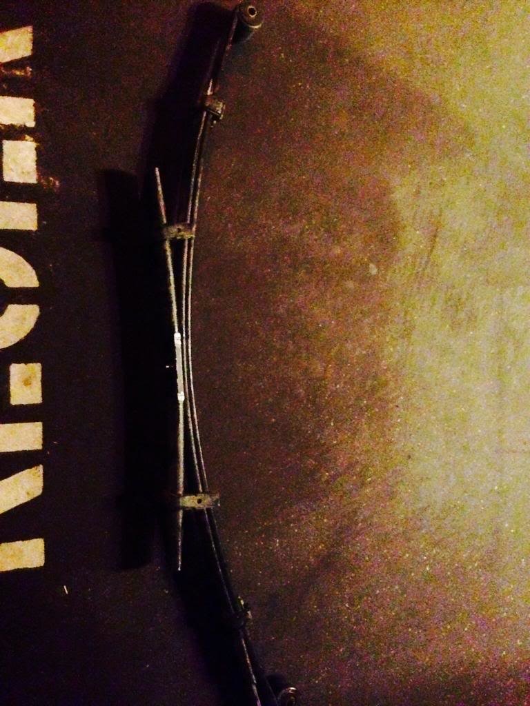

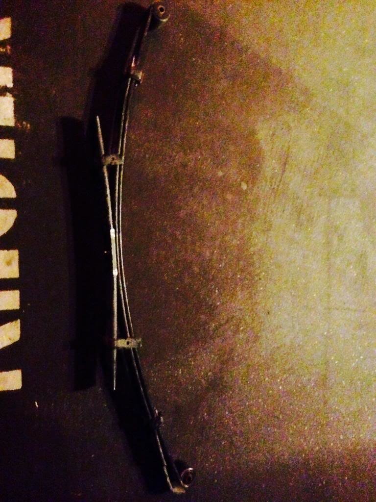

    Current:
    New Leaf Springs
    Not the best pictures, but it gives you an idea.

    X 2 ^ That's what I would do !

    You'll probably get a temporary lift but I wouldn't expect it to last. They're still a crappy stock 3-leaf pack so they'll probably flatten back out pretty quickly.

    Pretty normal on tacomas to have leafs that look flat or have a reverse arch appearance.

    get an extra leaf installed before you install them in your truck
