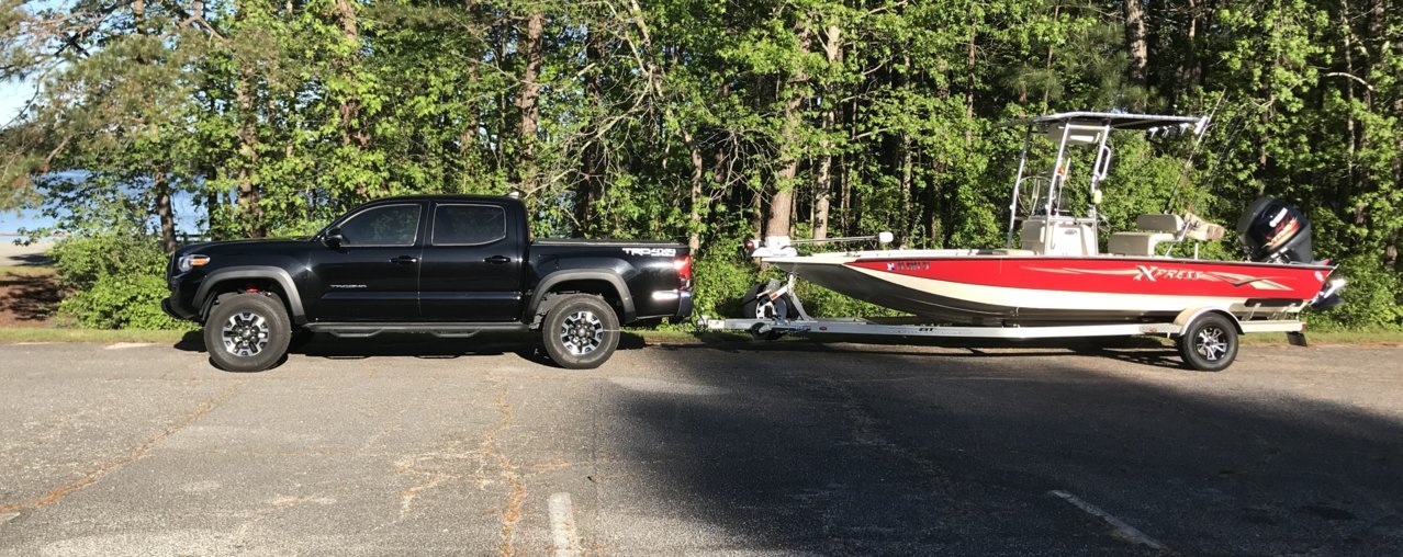

    I tow this 20 foot Center Console several times a week, plus trips to Florida. Not once have I needed 4WD. Your truck should pull your boat brother.
