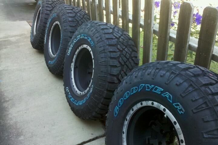

    Yeah it's taken care of now and Tire Rack is paying for the Balance. I do have stubborn tires to balance 33"x12.5x15" DuraTracks mounted on 15"x10's with a 3.74" backspacing and -44mm offset so there's a lot of rim on the outside of the wheel. Here's a shot of the wheels and tires.

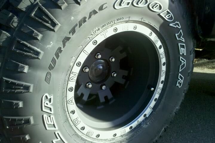

    13oz of weight is a lot theres no that tire is being balanced correctly
    or theres something wrong with the wheel is it bent
    Or theres something wrong with the guy doing the balance
    if this guy put 13oz of weights on your tires/wheels somethings wrong
    that should never have left the shop like that
    Lisa all can say is find a new shop
    I would like to see a pic of that wheel with 13oz on them
