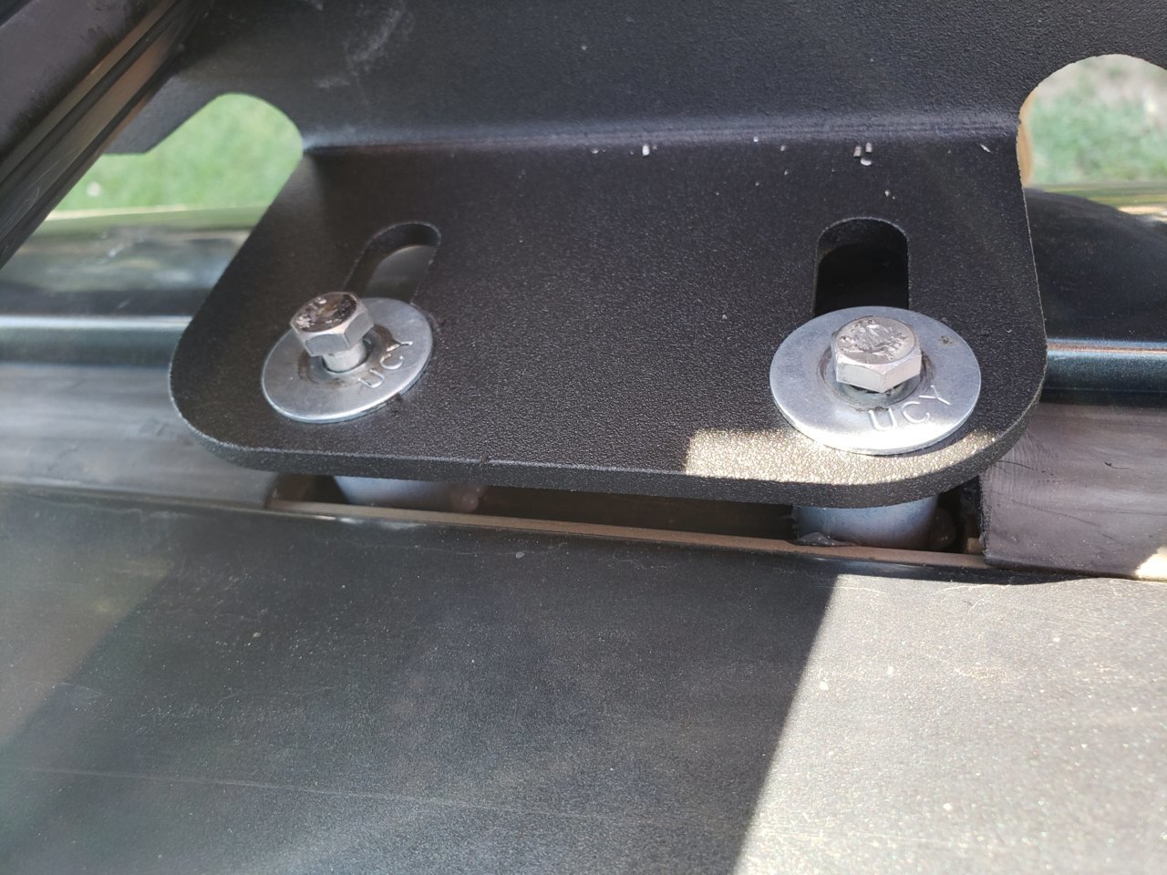

    so i just eventually had to partially take liner off and add washer + nut.
