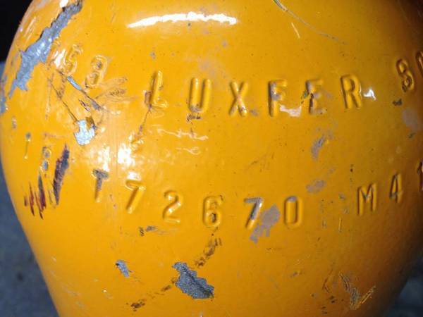

    Also, op, take a picture of the lettering stamped onto the tank, that will give us the numbers we need

    Hydrostatic testing is every 5 years. The original hydro done when that tank was made is from '98, so it would have to have another spot along that same area of the tank with a 4 digit month/year. The dead giveaway would be a stamped area with no yellow paint inside of the numbers. Hydro is only $35 at locally for me at a chain sporting goods store, but may be more in your neck of the woods.
    Scuba tanks have a burst disk on the 1st stage (valve at top) to prevent them from blowing up. Not sure what it takes for that to happen short of the tank busting the 1st stage off.
