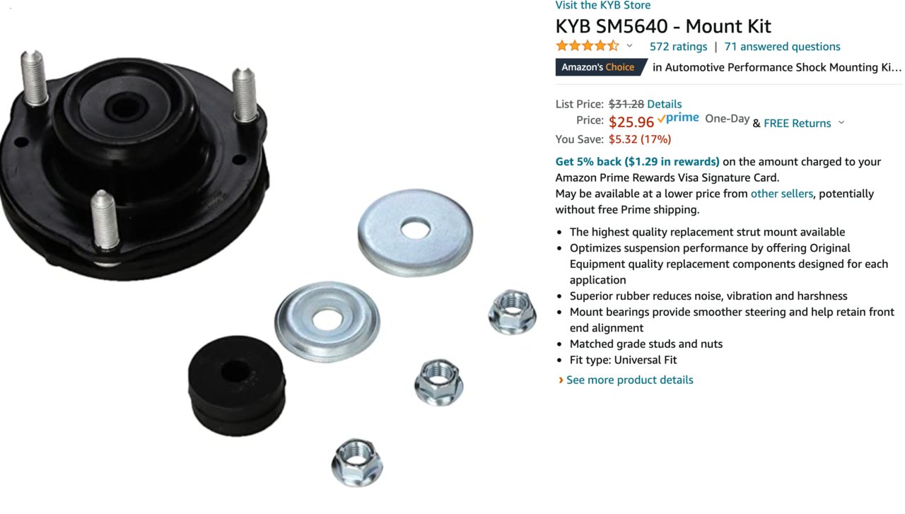

    @Key-Rei Are you talking about these? I Picked these up too Screen Shot 2022-01-07 at 1.28.03 PM.jpg

    Negative, that's a top hat for the coil/shock.
    I'm talking about the actual bushings that go between the body and frame.
