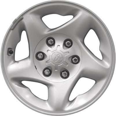

    Ok thanks. So any stock 16" wheels and above will fit no problem?
    Also, to be a little more specific, I'm looking at ones that looks like these.

    not ALL 16 inch wheels clear 2nd gen calipers fyi

    Thanks. I've read a few discussions on some 16" fit, whereas some don't. Is there a general rule of thumb to know what 16" wheels will or will not fit a 2nd gen tacoma?

    really wouldn't know other than finding a donor wheel and doing a test fit, a reputable company should be able to tell you what fits or not tho
