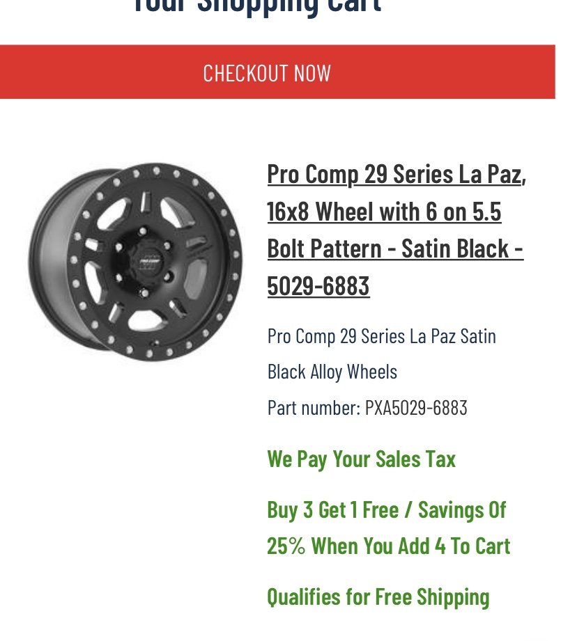

    Just bought these wheels for my 2018 Tacoma 4x4 and I was wondering if stock lugs would work or if I’d need extended lugs due to the lower offset0FDAF815-BDAE-45FF-8978-4FFD790D4491.jpg . Appreciate the help!

    Any idea? Thanks

    There are more than one style of “stock lug nuts”. Which ones do you have? Which wheels came on your truck?

    You're almost certainly going to need acorns, so no, it's unlikely your stock "mag" lugs will work.

    You’ll need aftermarket cone seat lug nuts. M12x1.5

    Yep. Cone, conicle, acorn.
    ^ all same, different verbiage.

    Stock ones will not work

    Toyota wheels will accept the stock lugs so long as you already have aluminum toyota wheels.
    If you have a base model with steel wheels you'll need the stock toyota style lugs for an aluminum wheel.
    Lugs that look like this -
    This will help to illustrate the differences -

    You might be able to get by with the factory ones, but I’d recommend hex nut extended thread without the washer

    Trd off road 2018 wheels
