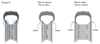

    Don’t do this, use wheels that fit. Tires are the only contact you have with the road. There’s a reason the manufacturer didn’t go with 7”upload_2024-5-25_13-8-51.png
    Also, if your tire is wider than the recommended size for your particular rim, the tire could lose some air. Any deviation from the recommended size for your particular rim can have a negative impact on Rim Ringz™ and it could fall off the rim.
