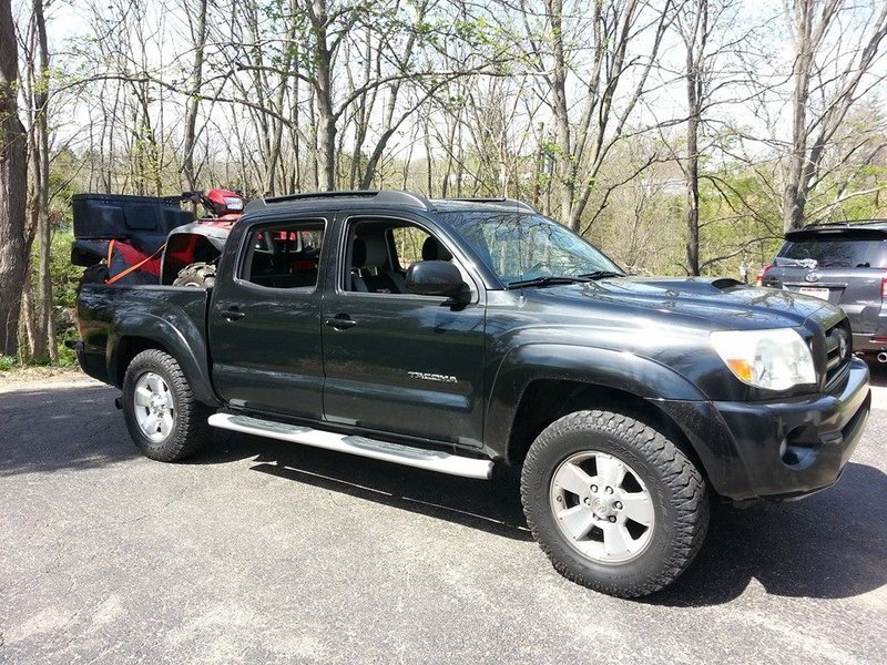

    Here is a pic of my 07 DCSB with my Honda Foreman 500 in the back. The back wheels rest on the tailgate, never had an issue. Also, to lessen the chance of busting out the back window I ratchet strap the back rack down to the bed D rings

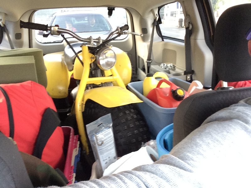

    They are unstable, and require a specialized riding technique. The reason they are dangerous is because a 5 year old could jump on one and hammer it in a straight line; problems arise when an inexperienced rider tries to corner without practicing the cornering technique, which I will admit is unintuitive. Turning left means leaning over the right side with the front wheel turned left so the left rear wheel will come off the ground and break traction. No rear diff, solid axle driven off a chain and sprocket. Do it to quickly and you are going for a roll with a 300lb trike coming along for fun.
    Don't lean enough and you aren't turning, you are plowing straight ahead into whatever obstacle is in front of you.
    Here's a pic of mine, all set for hunting. Portable isn't even the word for it, I could lift it into my minivan easily without help, ramps, nothing. And it burned about a pint of fuel every 3 hours.

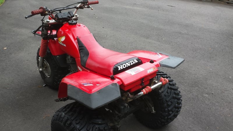

    Is that an ATC 90? My parents got me a used one for Christmas when I was in second grade back in the early 80's - it was slow but with low range I could go anywhere. I had that thing for 20 years, I could load it in the back of the truck no problems by myself without a ramp. Good times.

    Indeed it is an ATC90 :)
