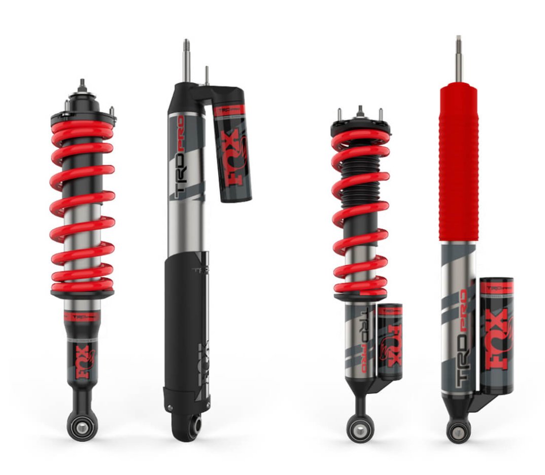

    If you pulled the TRD PRO FOX suspension kit off your new Tacoma PRO, Ill buy it. Please message me.
  4. Oct 8, 2019 at 4:00 PM
    #44
    Toki
    Toki Don’t get killed by Theta.
    Mar 28, 2018
    #248758
    532
    Jon
    San Jose, Ca
    2018 Tacoma 4x4
    Little bit of this and a little bit of that but stock af.
    Those look different than the ones I used to have.
  5. Oct 8, 2019 at 4:50 PM
    #45
    Pro-Taco
    Pro-Taco Well-Known Member
    Nov 5, 2018
    #271763
    1,324
    Lou
    Commiefornia
    2019 OR DCSB 4X4 Prem/Tech Cement
    All TRD Pro parts
    Those are not from Tacoma.

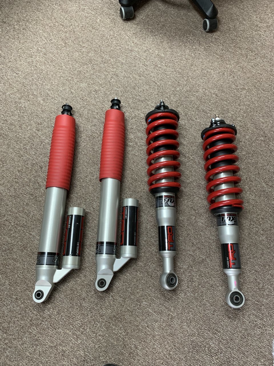

    The rods are too long. This is how Tacoma ones look like (mine):
    uploadadventure likes this.
  9. Oct 8, 2019 at 5:31 PM
    #49
    crowder
    crowder Active Member
    Jul 25, 2015
    #160268
    25
    What year of Tacoma did you put those on and do you know where they are sold?

    I bought them from a member on here. He took them off at around 1000 miles from his 2019 Pro and they went on to my 2019 OR. Very pleased with the outcome. The best part, my dealer serviced and performed a sensor recall on my OR without any problems, even gave me a free alignment for which I was willing to pay, go figure.
