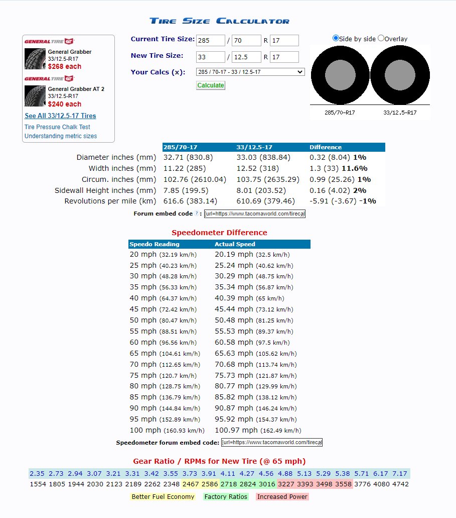

    Will the truck/speed sensors notice if a truck has two 285/70/17 and two 33x12.5x17 tires?

    Maybe:

    Your center driveline will sure as hell notice.
    Never run different sized tires on 4WD/AWD vehicles.

    Although the overall difference between these 2 tires is not a lot, we never recommend intentionally mixing tires sizes. As the other members noted the biggest concern would be if you were to engage 4wd.
    We would consider trying to find a matching pair of either the 33 or the 285 as the potential drivetrain damage is going to exceed the cost of 2 tires.

    Having run mismatched 265/70-16 and 265/75-16 tires for over 1100 miles on and off-road, no the truck won't notice.
    It is not advisable to engage 4WD on pavement with this setup, unless you also play with tire pressures so the front- and rear hub heights are the same. Put the slightly larger tire over the front axle if you plan to drive with an empty bed.
