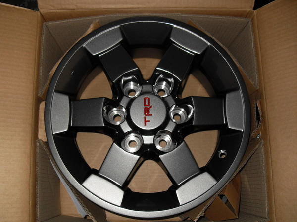

    i want the new trd rims on my 2003 toyota tacoma prerunner silver.
    Will they work and better yet will the look good?

    They look great, why wouldn't they work? 6 lug toyota rims.

    The wheels will work depending on what size tire do you want to run.

    I think I have those exact ones. I love them and get lots of compliments.

    yea just can't run a 12.5'' wide tire on it.

    what do you mean 12.5 wide tires? still new to the tacoma tire world. what sz tires would you recommend for those rims?

    exactly that..no 12.5'' wide tires..like a 295/75 wouldn't be a good idea since the FJ rims are 7.5'' wide rim. You'd end up running far too low a psi to keep even wear on the tread.
    a 285/75 would be fine though (11.5'' wide)

    Looks like a 265-70-16 or a 265-75-16.Bf goodrich rugged trail. I like the bfg rugged terrains.. 75-16 would be the biggest size you could run without wheel spacers
