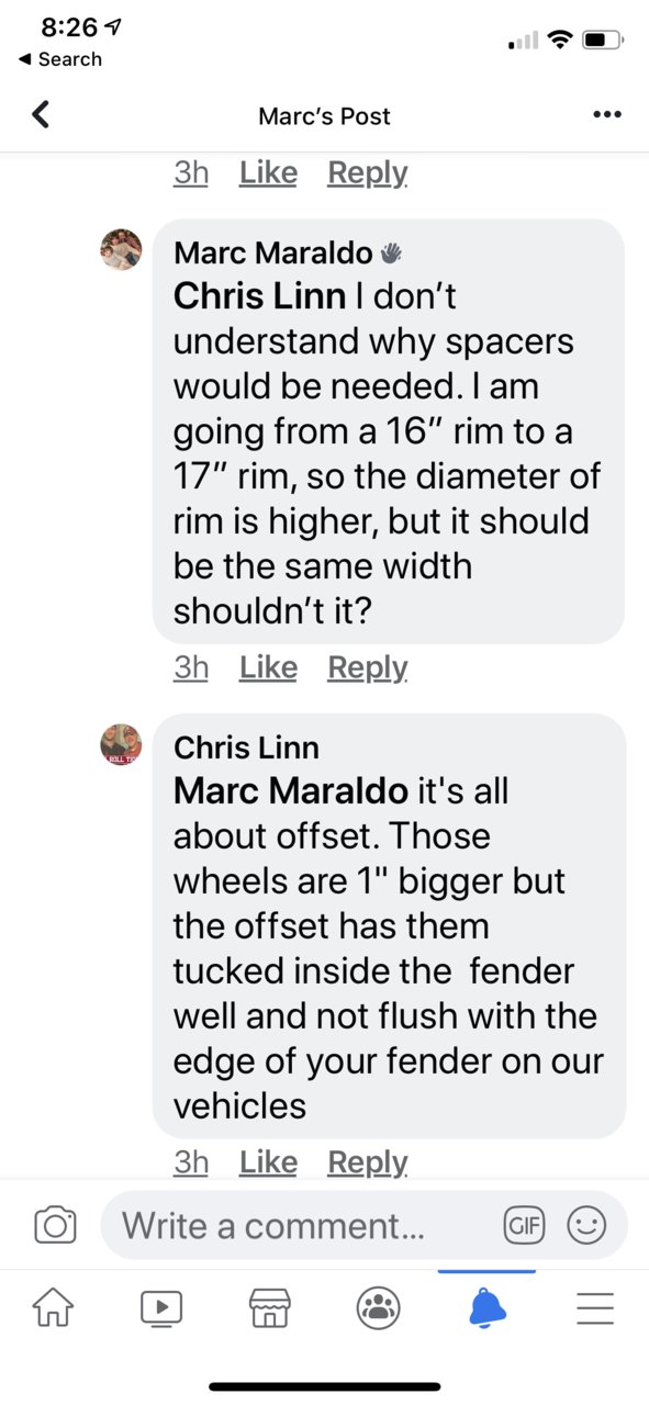

    I’m getting conflicting answers which is why I’m posting here too. 24899534-861D-4E52-8F98-8620CF82A782.jpg

    The conflict is that dude is wrong.
    There is absolutely no wheel that has ever come standard on a Tacoma (1st Gen Tundra, or 3rd Gen or later 4Runner) that will not work on a 1st Gen Tacoma.

    He (Chris Linn) has a point when he mentions offset. The wheels you are asking have a higher backspace than your stock wheels. This brings them in closer to your suspension. Stock 1st Gen wheels are approximately 4.5" backspace. 2nd/3rd Gen wheels are approximately 5.25" backspace.
    You'll most notice it at the top of the steering knuckle @ upper ball joint. Not much room at all. You'll also scrub the frame at full lock.
    Nothing says you can't run them - many do, hell... I did (well, the 2nd gen off road wheels until I got tired of the tire scrub). Just keep in mind they are in fact different than your stock wheels.

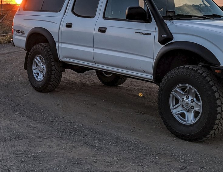

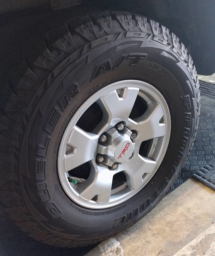

    The distance from the edge of the tire to the UCA/ball joint will remain the same no matter the lift. And when I had a set of 2nd gen wheels, I couldnt get a fingernail between the tire and the ball joint. I would run skinny tires if I wanted to go bigger diameter. But that would look really goofy haha. Trust me, its quite noticeable with how far in they sit.
