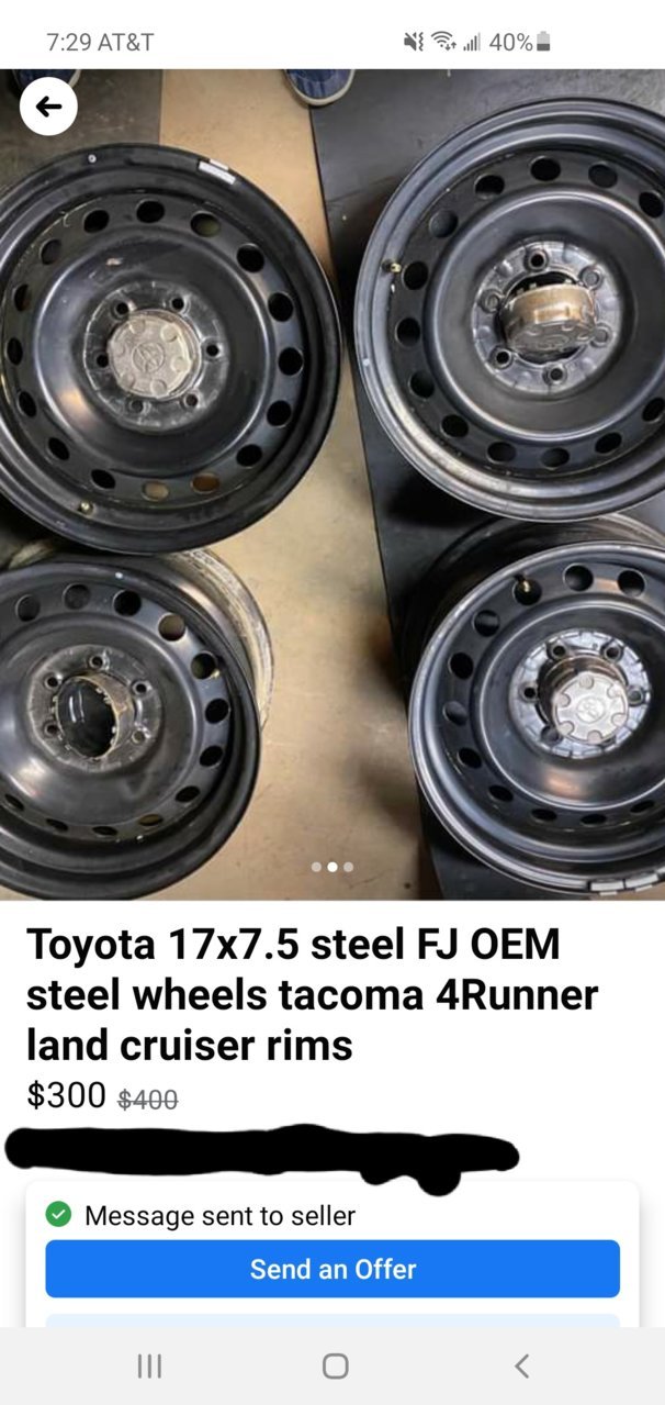

    Will these 17 x 7.5 rims fit on my first gen double cab TRD? Sorry for the potentially noob question. I'm interested in getting these for running some winter tires. Curious if I would need wheel spacers or anything. I have a 1.5 inch lift with OME 881s and 5100s. I am also curious what tire size would fit on these rims.

    When I bought my truck it had those on it - not much backspacing - what tire are you planning on running?

    I would like to run whatever the stock equivalent is with these 17 inch rims. Does "not much backspacing" mean it might rub on the upper ball joint?

    From what I remember from back almost 4 years ago there was roughly 1/2”-3/8” between the TC uppers and the KO2 255/85/17’s but it’s obviously been some time since then.
