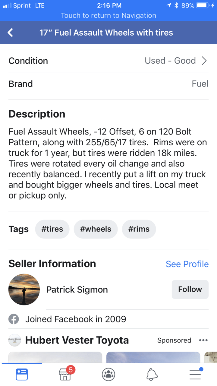

    Attached is a description of wheels I am interested in. Will these fit a Tacoma sport 4x4? Thank you!

    No. Toyota bolt pattern is 6 on 5.5inch or 139.7mm
