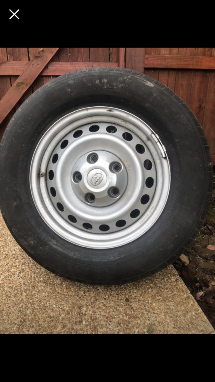

    Found these for sale locally near me. Says they are for a Tundra but want to put on my 2wd 08 Tacoma. Anyone know the size and if they will work on an 08 2wd? Thanks for all advice

    My 08 2wd Taco is a 6 lug, is yours a 5 lug?

    Mine is a 5 lug yes. Do you have the PreRunner if it's a 6 lug?

    Plus Ive researched and it appears the 2WD Tundra bolt pattern is different that the 2WD Tacoma. 2WD Tacoma is 5 x 144.3 and the 2WD Tundra is 5 x 150. So these probably won't fit on my Taco.

    6lug 2wds are prerunners, so yes he does
