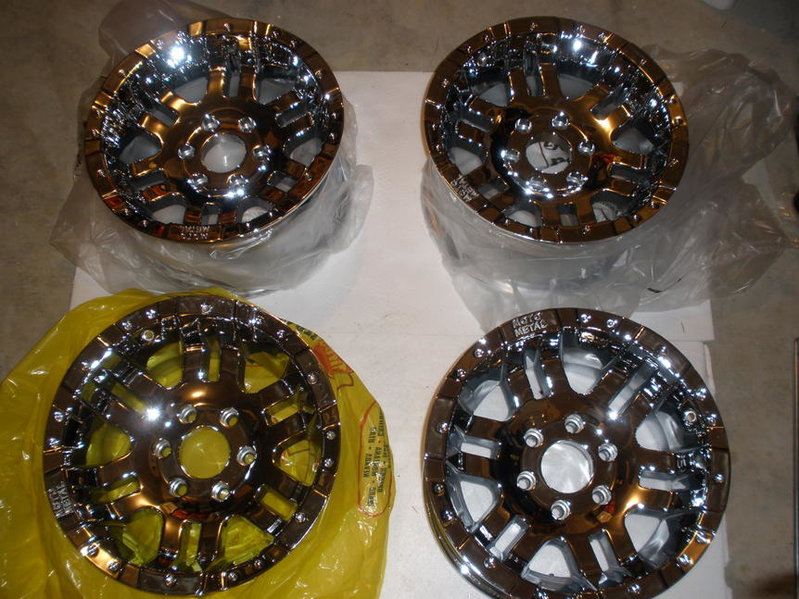

    Ok i'm a little confused about hub and hub centric but i was understaning that these wheels would not fit my 09 tacoma but then i found a car on cardomain that has them on them!!
    here is the link to cardomain
    http://www.cardomain.com/ride/2546468/4
    and here are the wheels i bought on craigslist

    The hub is the center bore size, if those are for Nissans they will not fit. If they are for Toyotas or Chevys then they will. As long as the bolt pattern is 6 on 139.7mm. You can always have the bore milled at a machine shop, if it's too small. Hope that helpds.

    the bolt pattern does fit its just the bore that doesnt i figured maybe a spacer but didnt want to go that route.
    also i bought them because the bolt pattern did fit

    Don't use a spacer, just have the hub milled out to the toyota size.
