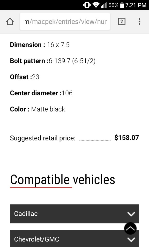

    Based on specs, looks like it will fit.
    Looks like car wheels but if you click the compatible vehicles below, they are all SUVs or Trucks.
    Anyway, price is close, if not more expensive than other well known brands. Do you like the look? What's your build plans for the truck?

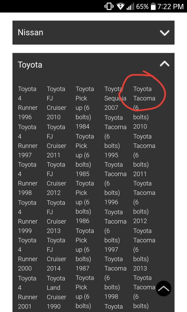

    From the link you provided

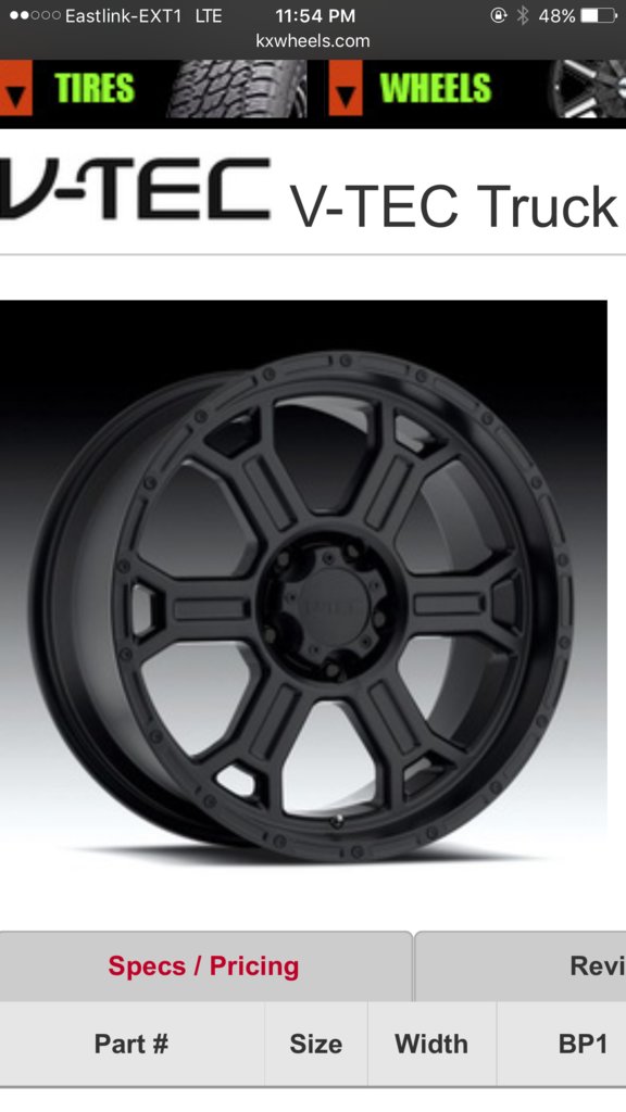

    thanks for the fast replies. I actually like the look. I really like the look of the level 8 rims and also the KN OffRoad wheels etc. This is pretty close. I can get these wheels for about $600 CND 16"
    my build im looking at is just 16" wheels 5100 blistins (maybe the 6112s) and 265/75/16 tires and thats about it...

    That's another thing I was wondering about. The offset. Most offset rims I see are -12 etc. These are +23. Hmmmm

    OP, stock snowflakes on the OR trim are 16x7 +25 offset. These wheels are very close...can just swap wheels and go with the tire size you're listing. Some will like a little more aggressive offset towards the 0mm range, but totally up to you. I would avoid doing wheels spacers if the lower offset wheel option is available.
