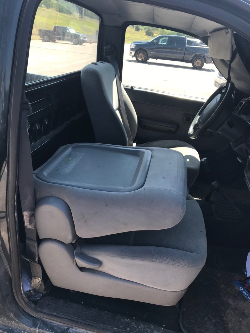

    I had bench seats in my 96 then swapped over to the 2001 buckets. Holes and feet were not even close so I had to remove the brackets on the 2001's and install a bracket kit adapter from a company that specializes in seat bracket modification.

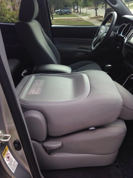

    those don't look like they are out of a Tacoma. The base seems way too thick and I've never seen that plastic tray either. Are you sure they aren't from something else like a Tundra?
    drewskie and GQ7227 like this.

    Just FYI, those are not 01-04 buckets. I can tell by the plastic trim at the bottom. Those look like 03-09 4runner buckets.
    billybop90[QUOTED] and Wulf like this.

    To tell you the truth I honestly dont know, I purchased these seats in 2014 from a Toyota guy off craigslist in the Seattle area and he stated they are from an 01 Taco. He had a bunch of Toyota's in his back yard and they were in various stages of dis-assembly. If they are Tundra seats that would explain the height increase.....all this time, I had no idea...

    Well I'll be a sea monkeys uncle....never knew..
    Probably why they did not exactly bolt into the Taco, they sure are comfy tho:D

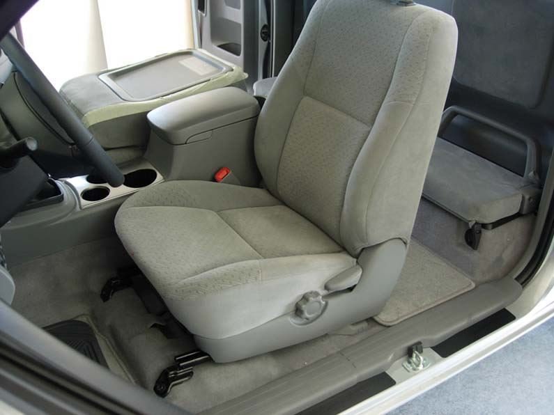

    After doing a bit of research this is what I have found. The seats that I have are from 2009-2015 Tacoma seats with the passenger seat fold flat option. Sorry if I had confused folks out there stating that they are 2001's. Well, at least I only paid $100 for the pair. Images are from other websites selling 2009-2015 seat covers. Thanks to Wulf and Nzbrock for pointing this out, now I know better.
