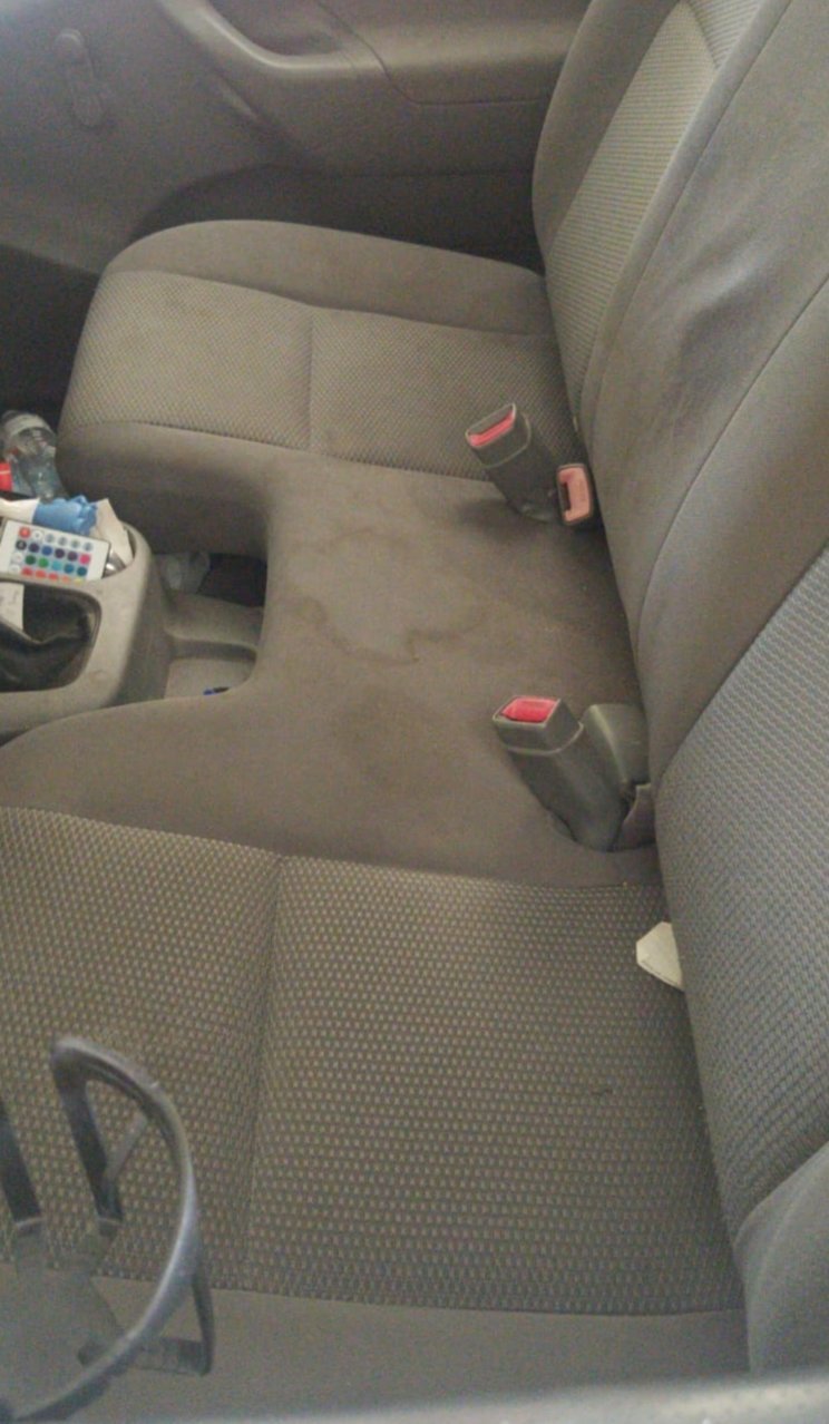

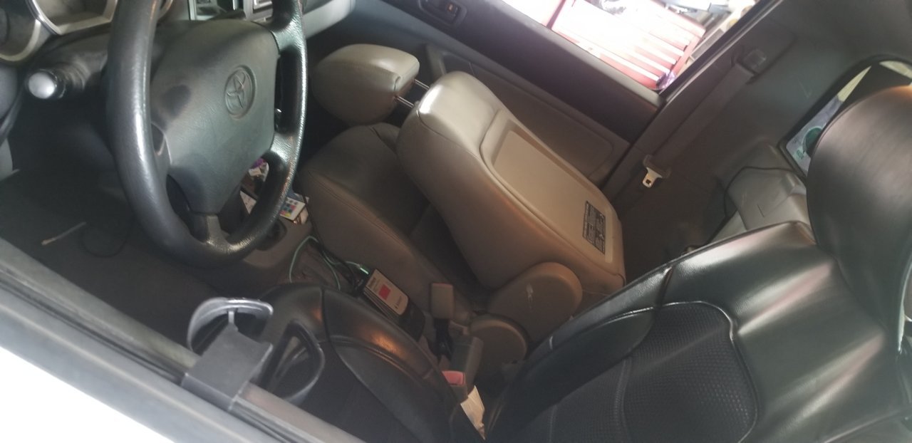

    20200725_164149.jpg SmartSelect_20200725-160709_WhatsApp.jpg So i did the seat swap now all i need to do is the wiring for the srs since at first look the connections are not all completely the same will post later all i did.
    My truck 2nd gen base taco seats off a 2nd gen extended cab. Direct bolt on
