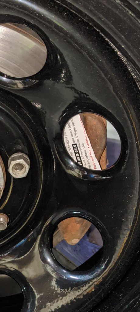

    No fit. the wheel barrel size isn't the only factor to consider, the inward lip on each stamped hole in the wheel may interfere with the caliper as well.
    I test fit 17x9 procomp steelies and they barely cleared my stock calipers while static FWIW. I had about a sheet of paper worth of clearance between the wheel windows and the caliper. I would expect it to run while driving due to imperfections/flex in the wheel

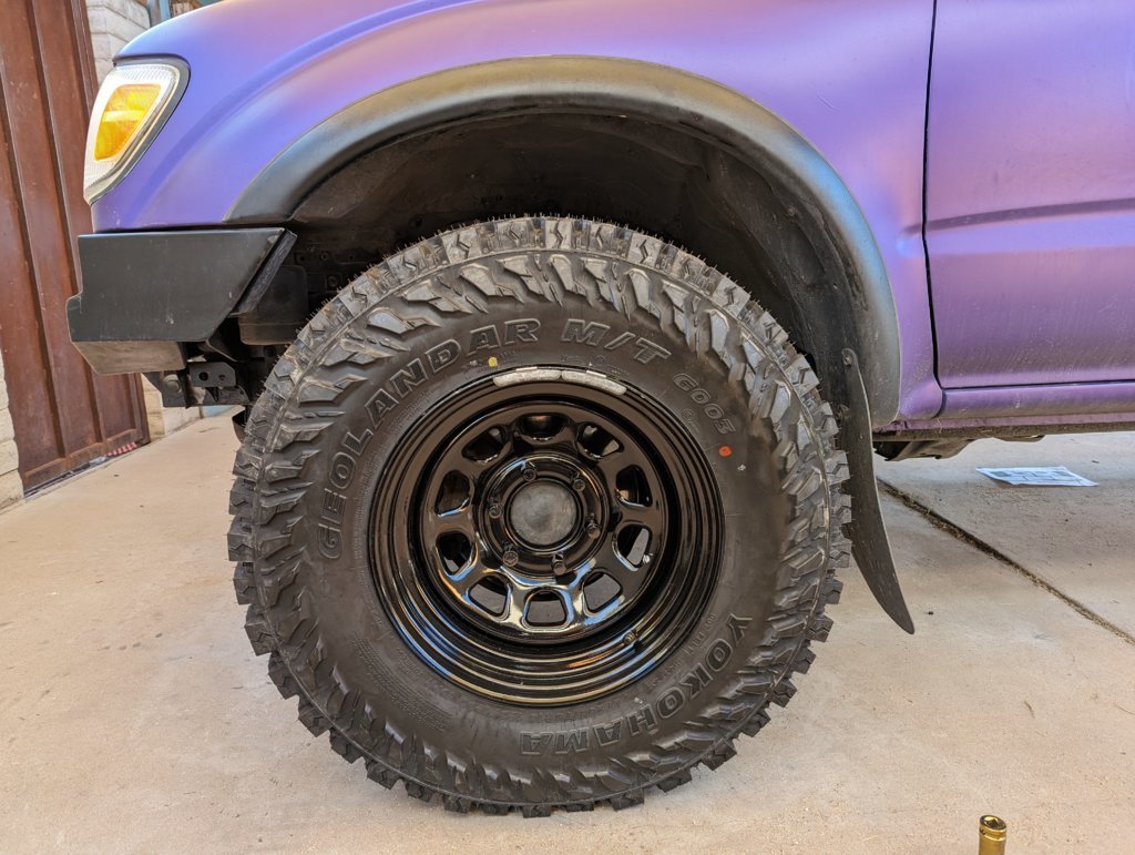

    Fifteens will not fit with Tundra brakes, just too small a diameter.
    I have sixteens on mine, with Tundra brakes, and I originally went with a one inch spacer, clears fine.
    A little more investigation and I can go with a half inch spacer, extended studs and my wheel will clear.
    I suspect these steel wheels are all about the same, and I have Vision 84 D wheels.
    You won't really know until you try them....
