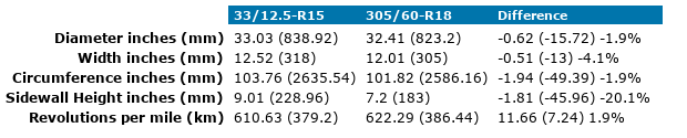

    It's going to be close with a 4.5" BS I'm running 33/12.5's with a 3.75 BS and I rub the frame at full lock and full compression but it's not bad on the street I would never hit.
    from the online tire size calculator

  13. Sep 8, 2011 at 11:46 AM
    TexasTacoma37
    TexasTacoma37 Well-Known Member
    Sep 3, 2009
    #22227
    31,174
