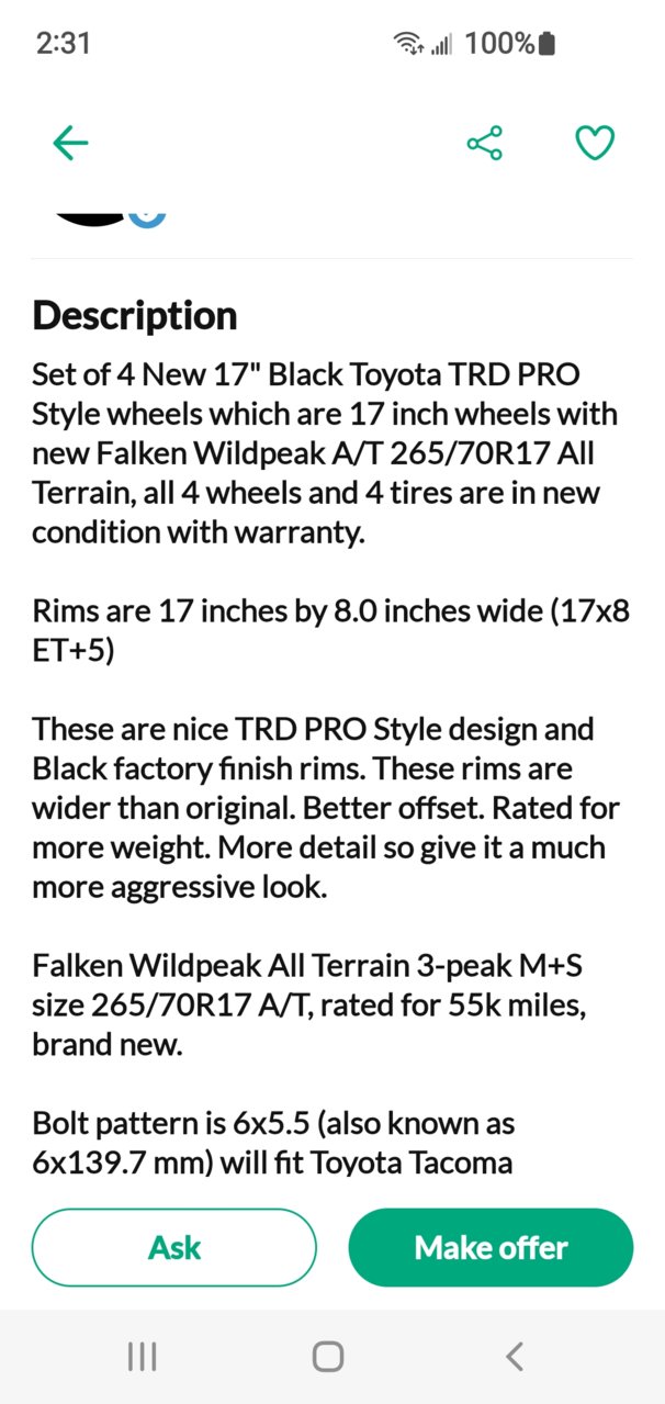

Will these wheels fit my stock 2007 Toyota Tacoma TRD pickup?

    6. Lug will fit all 6 lug tacos
    So yes

    Yes they will fit. Any rims from a Tacoma, 4runner, FJ Cruiser, or 3rd Gen Tundra will fit as they are all 6x5.5 lug pattern and same bore size.

    Personal preference, but TRD Pro STYLE wheels make me a little nervous. All the ones I've seen around me are no-name knockoffs. If you have some time to look, Toyota factory takeoffs are normally available for about the same cost.
