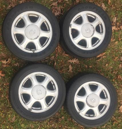

    04 4x4. Will these wheels (just the wheels, not tires) fit my tacoma?

    Is a picture missing? Based on the info you provided and your vehicle info, it looks like you're asking if the '04 4x4 rims will fit your '04 4x4.

    Generally speaking, 6-lug Toyota will fit 6-lug Toyota, assuming 106 center bore. Where you have to be careful is offset/backspace when you move up in tire size.
    What size is the rim? Most OEM rims of the '04 vintage are 16x7, I think.

    Damn, sorry. The attachment didn't attach.....
    Updated now. I apologize.

    In my opinion...invisible wheels will fit any Tacoma.
    J/k:)

    So, should they fit? They are 16x6.5. The reason for getting them, I am selling my truck and want to keep my wheels as there were from my old 4runner that is now gone.

    Those are Lexus. I guess from a GX? You don't show bolt holes but if 6 lug, they should fit well enough to sell with.

    AFAIK, most Lexus GX vehicles have only 5-lugs. Pop off one of the center caps to see.
    Even if they are 6-lug, they still might not clear your calipers.

    Also make sure that the center bore is large enough.
