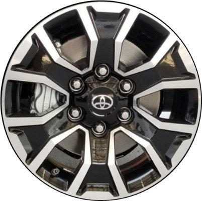

    I have a 2016 SR5 XP Tacoma with 265/65/17 already on them that’s not oem and was wondering if these Tacoma Sport wheels would fit here’s the part number
    #4261104200

    Yes, a 265/65/17 tire is what comes stock on those stock TRD Sport wheels. It's 7.5" wide with a +20 offset, do you know the width and offset of your current wheels?

    Yessir, those will fit!

    Yes, and those wheels look good with Nitto Ridge Grappler 265 65. 17 especially since you have the XP badges IMO.

    P265/65/17 is an OEM size (comes on the Sport) as is P265/70R16 (OR and Pro), P245/75R16 (SR and SR5) , and some 18” size (limited) I don’t know off the top of my head. All of them will fit on a 3rd gen taco regardless of trim (provided you have the correct wheel diameter).
    Note that XP is an appearance package sold by some dealers in Florida. For all practical purposes, you have an SR5.
