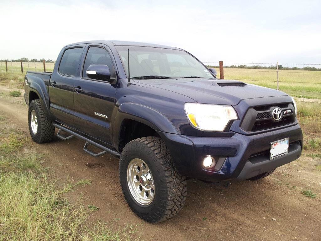

    I have the Level 8 Trackers and they are 8.5" wide. All 265/75/16 tires reccomend a 7-8" wide wheel. This is the reccomendation, they have to have a cut off point some where..and I dont think .5" is a big deal. The 265/75/16 look fine on my 8.5" wide wheels (actually I think they look great)...and the techs at Discount said .5" is not a big deal. Think about it...it is only .25" wider on each side of the tire when mounted on the rim, that is nothing. There were no issues mounting, balancing.
    They dont rub the calipers at all, but with the wider wheel, the tires rubbed when turned all the way, even with the front mud flaps removed. After I installed the Bilstein 5100 set at 1.75" in the front, no rubbing at all.
