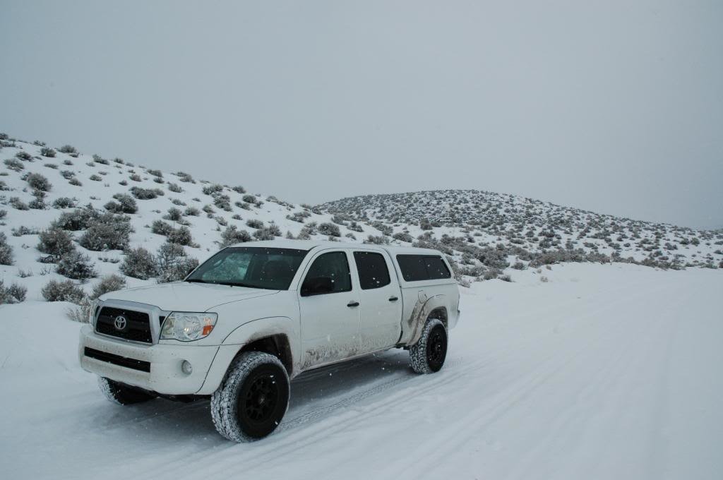

    I think you would want the wheels with the -6 offset. The link you provided in the first post shows a 18 offset. Not sure how those fit.
    I'm running the same wheels with the -6 offset in 16" with 265/75 Cooper Discoverer ATP tires. These tires are also rated for a 7-8 inch rim but like was stated before .5" is not going to make a difference.
    No rubbing anywhere. I'm lifted a little over two inches right now, but had these on the stock suspension with no issues.
