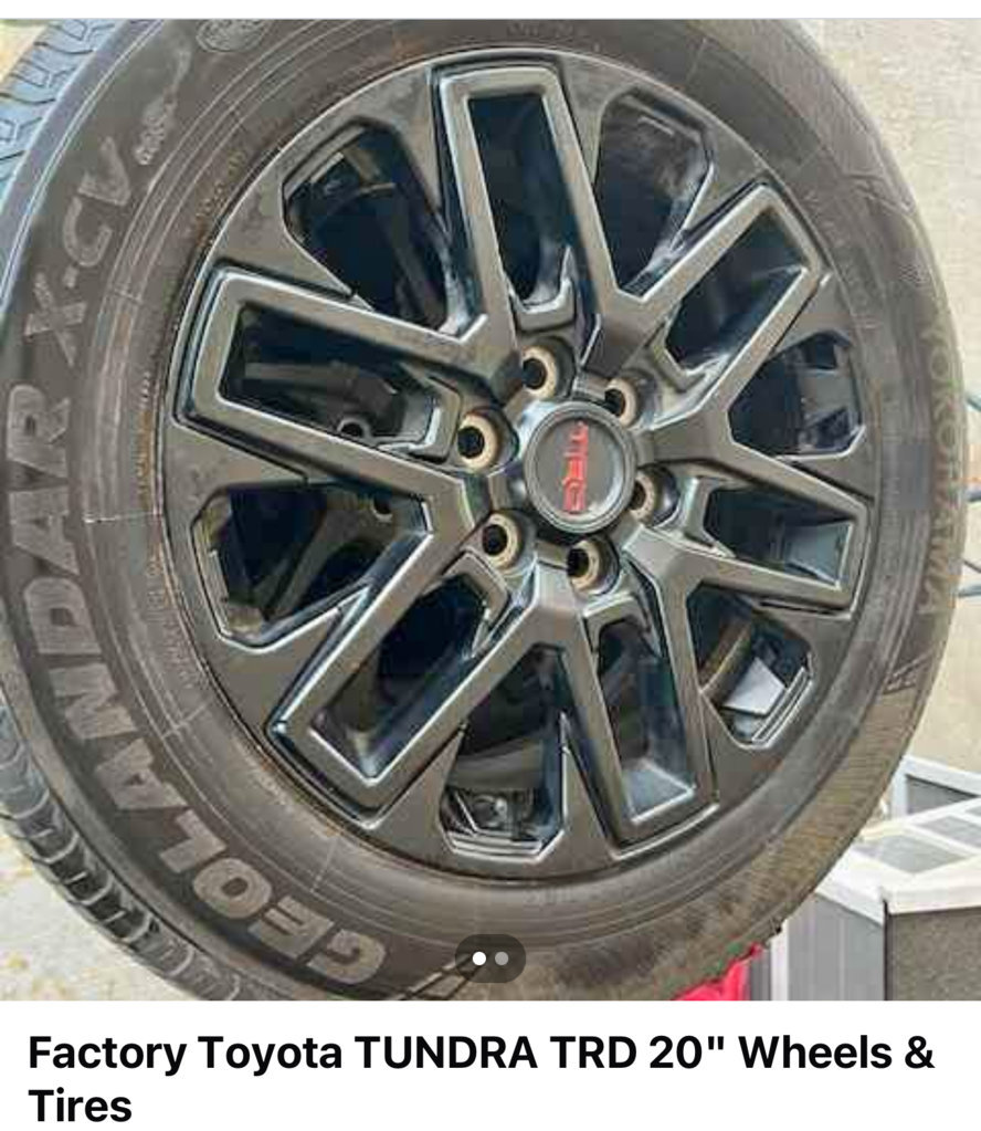

Will these wheels fit on my 2022 Tacoma ?

    Yes, some 20 inch wheels that fit a Toyota Tundra will also fit a Toyota Tacoma. The bolt pattern for a Tacoma depends on the year and drivetrain, but it's usually either 5x114.3" or 6x139.7". The latest generation of Toyota Tundra has a 6x139.7 bolt pattern.

    The bolt pattern on a 2022 Tacoma is 6x139.7 so if you have the Tundra wheel with the same bolt pattern you are all set.

    Need to include which year and trim those are to help dial in the offset aswell

    You need to know what tundra those are coming off of

    @Veet-88
    Factory Toyota TUNDRA
    20" Wheels
    6x5.5 or 6x139.7 Bolt Pattern

    Even if those fit, they don't fit on a Tacoma.

    Why not if it’s the same bolt pattern ?

    We need the year and trim of the truck they are off of. That will tell the wheel offset and tire size.
    I'm assuming the overall size is going to be to big and may require clearencing. Also if they are off the latest gen they will not work based on the offset. Previous gen you may get away with it.

    OP, even though they are the same bolt pattern and will bolt on I agree with @Veet-88 they will look ridiculous.

    There's a lot more to it than bolt pattern. Bore size and offset are just two factors that come into play.

    No, they will not fit without spacers. The hub bore is too small, and they have a very high offset. They will fit the 4th gen Tacomas, though.
