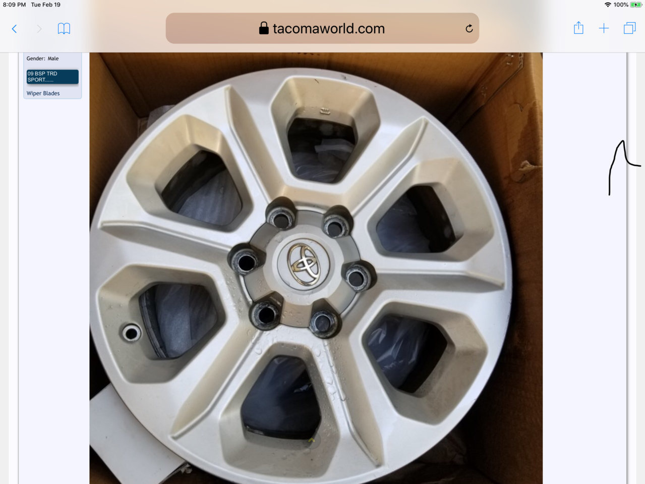

    Has anyone tried these 17” 4 runner wheels on their 3rd gen Tacoma? I’d like to find a set
    of these for my ‘17 SR but hate to buy a set without knowing for sure. Probably will stay
    with the stock tire size other than 17”

    I have them on my 2nd Gen, they came off of a 2017 4Runner. They should fit with No problem.

    Yes they fit. All of the 4Runner FJ and Tacoma wheels fit eachother provided they are all 6 lug wheels.

    while the others were posting, did some searching
    those look to be off a 2014-15 4Runner
    spec 17 x 7, 6 x 139.7 PCD, offset +15
    as others said, should fit

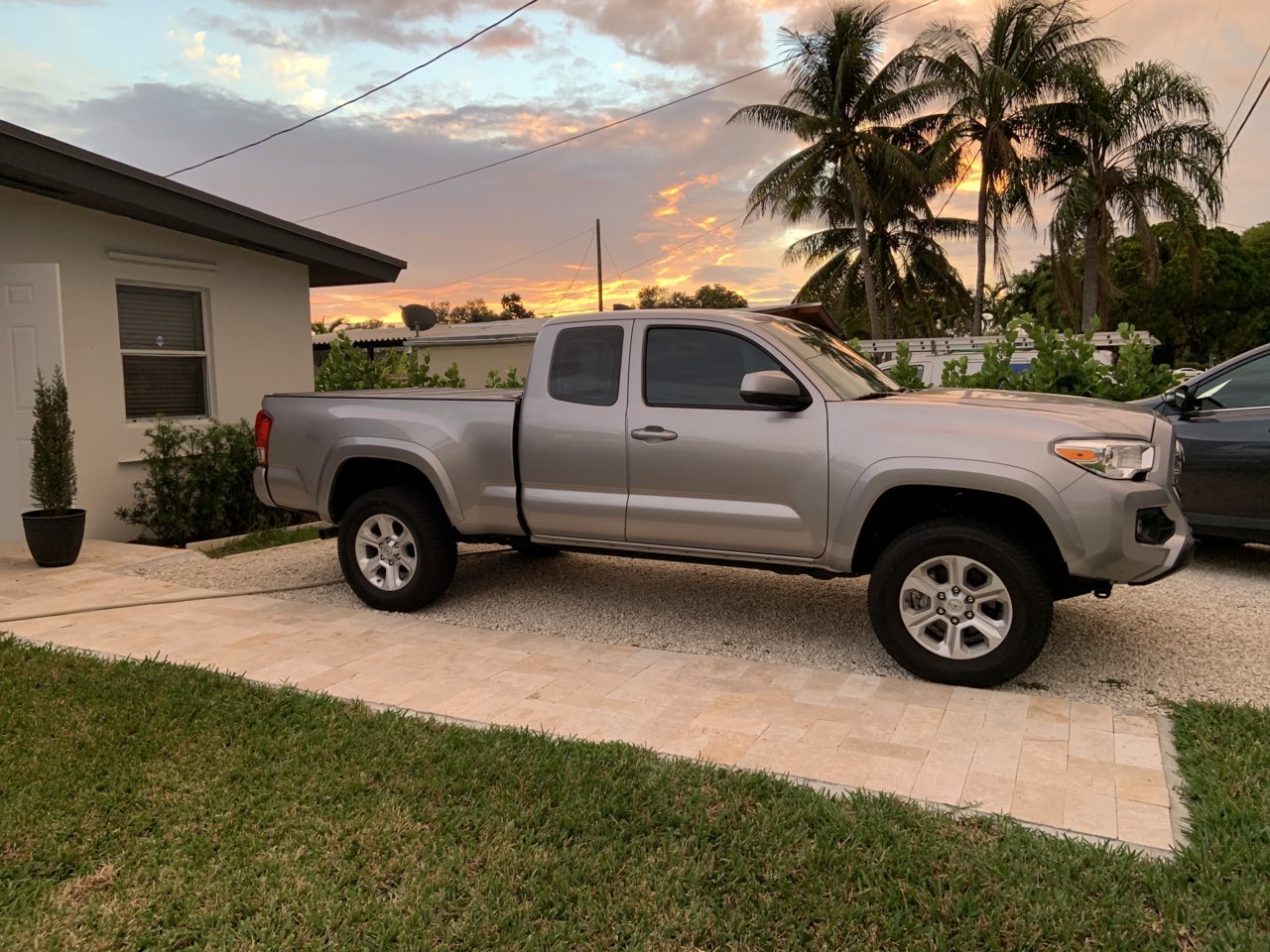

    What type of lugnuts did you use for those wheels? I currently have OEM sr wheels(steelies) and I’m upgrading to the 17’s in the first post. Will the steelies lug nuts work?

    Claudiomartinof what lugnuts do you have?
  13. Feb 21, 2019 at 3:53 AM
    Claudiomartinof
    Claudiomartinof Well-Known Member
    Apr 18, 2016
    #184668
    1,466
    2019 TRD OFF ROAD 6MT
    The truck came with it... I could take a pic later today but I would not be able to differentiate if lug nuts are the “regular” or other..
    Hope the pic helps you..

    The pictures really do help guys, Claudio that’s a beautiful truck you have. The way the wheels are designed adds some real depth and they
    look great on your truck. I found a new set in Scottsdale, but didn’t want to drive that far. ​
