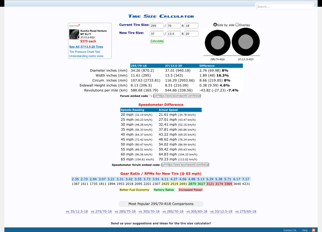

  11. Apr 12, 2020 at 10:55 AM
    icky crane
    icky crane [OP] DCLB ‘09 4x4 LT
    Apr 10, 2019
    #289677
    81
    FL

    The wheels for sale come with Toyo MT 37x13.5

    Oh good luck with that!!! Not sure if that is going to be enough offset to keep from hitting the frame and such also that size and width 37 you're going to need a lot of massaging to get them to fit

    Yeah it’s a killer deal but not my ideal setup. Probably gonna pass and go get the Coopers I want anyhow.
    Not worried about 37s fitting but that width isn’t what I’m after.
