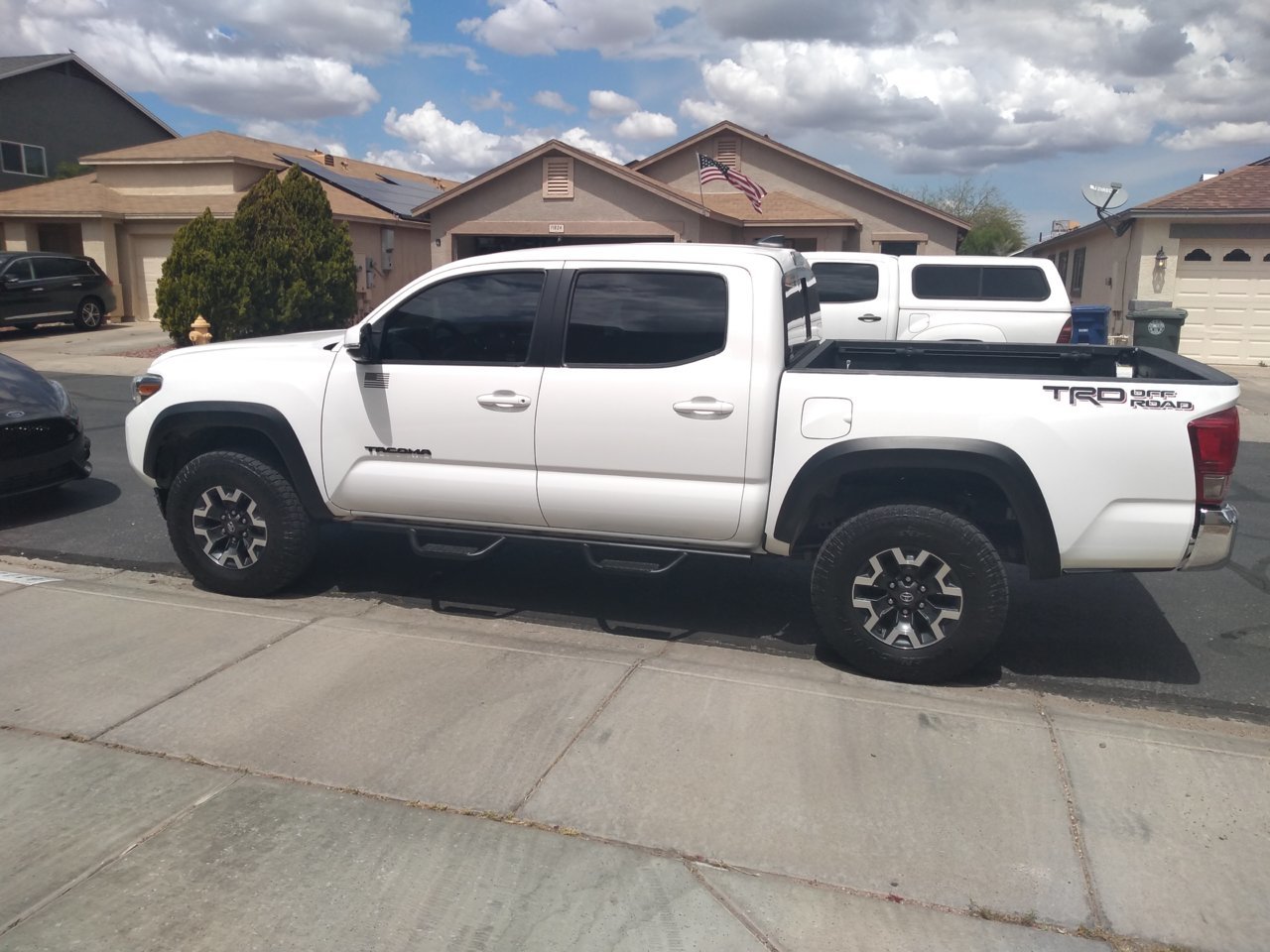

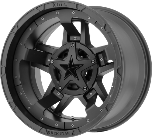

    Hello everyone I'm having some wheel solving problems. My wife and I are in the market for some new wheels and we are interested in the XD Rockstar 3 series wheels but I am wondering if the a 17x8 with 20mm offset will be good on stock suspension without rubbing or having to trim anything and the tire we will be running is 265/70/17. Any info helps

    I wouldn't run a 10.5" wide tire on an 8" wheel. It looks stretched. 7" wheels would be a better choice.
    As for fitment, +22 offset will keep them tucked in. Don't expect a +22 offset wheel to look like your picture. They won't have the deep dish look. They will look more like your stock wheels.

    With the wheel being wider but the offset similar to stock they will be closer to your upper control arms by a few millimeters.
    I would find a wheel with a lower offset like 17x8 0 offset or even -12 for a little poke.
    No cutting/trimming/hammering needed for that tire size.
