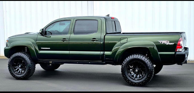

    That actually looks pretty sweet to me, but I get you. I'm not a fan of the 18" rims myself, but there's no way the new tire/wheel combo is going to rub as it currently sits. What is the tire size you are currently running?

    18
    2013 Tacoma Sport - Long bed
    Looks good…drives like garbage.
    Form follows function in my mind …and this function’s horribly. Soo retarded.
    275/70/R18 Grabbers with way too much pre load on the front spring. Garbage!

    Yeah, by the looks of it I would have guessed you were running 33s and that's what those are. The ones you're wanting to switch to are 31.6. If you're not rubbing now, you won't be after you switch and you should definitely be okay with taking some of the lift out of the current setup.

    2inch blocks in the rear I plan on throwing in the trash. Hope is to lower the front to 1”-1.5” lift. Can it be done…

    That was going to be my next question: how was the rear lift achieved? Yeah, ditch the blocks.
    It can be done. You're essentially taking it almost back to stock, which is going to ride much better.

    @Hogsnatcher, I had a similar set up on a 2014 TRD Off Road. When I bought it, it was lifted with spacers in the front and blocks in the back with a differential drop . The wheels were 18X9s but I cant remember the tire size. I removed the lift and went with Bilstein 5100s all around and then put on 17 inch 4Runner TRD Premium wheels with 265/70/17 Coopers. I set the Bilsteins up front to the #2 setting which was about a 1/2 inch lift. It rode way better and I never had any problems with rubbing.

    No, I wouldn't think so. The rear shocks are likely long travel to accommodate the 2" blocks, so you may have to replace them with standard travel ones.

    To run those 33s you are rocking a 3" lift in the front and 2" in the rear. Get your new wheels/tires mounted, pull the blocks, drop the front by 2", throw on some std travel 5100s on the rear and get an alignment done. That should be all there is to it. Your CVs are fine.
