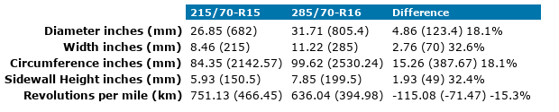

    Rims will prob fit, but the tires are WAY bigger then stock for a 5 lug.
    from the online tire size calculator

    the rims should fit. the tires will not. most wheels with a 5 on 4.5" or 5x114.3 bolt pattern will fit i am not 100% sure but i think the biggest tire without a lift that will fit is like a 29 or 30 inch...correct me if im wrong please
