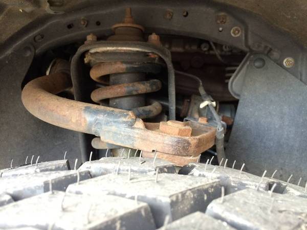

    I know... And I changed nothing. It's so weird. When they told me that I didn't believe them and they walked me into the shop to show me.
    The only thing I can think of is that; my 275's were bought with 50% tread left and they are a smaller diameter tire. They were close to the UCA then. I think the setting on my LR UCA may be wrong and was just lucky with the shorter worn out 275's. Now with the more meat and taller tire it puts it up in the range closest to the UCA... :notsure:

    Any chance they loosened the UCA top bolt and the ball joint slid in toward the UCA ?

    If you have LR UCA's, you have the ability to do some cool stuff with you alignment to get more clearance. You can set the UCA so that it pushes the upper bj forward more than stock then use the adjusters down at the LCA to get your caster back in line which will push the lower bj forward creating more clearance at the back of the tire. It's fussy but it might work for you. It also may be a ton of hassle that doesn't pay off at all. Something seems goofy though, if you can fit even a worn 275 but not a 255.

    Here are pics.. Now imagine without that 1.25" spacer.

    That's what I thought but negative, clear in the pis it wasn't moved ^^

    I think your ball joints might be in a funky position. They seem like they sit way too far inward toward the coil. Do a google image search for LR UCA on 2nd gen tacoma and take a look.
    Was typing this as you replied. They don't look to have been moved but they still look a little odd.
