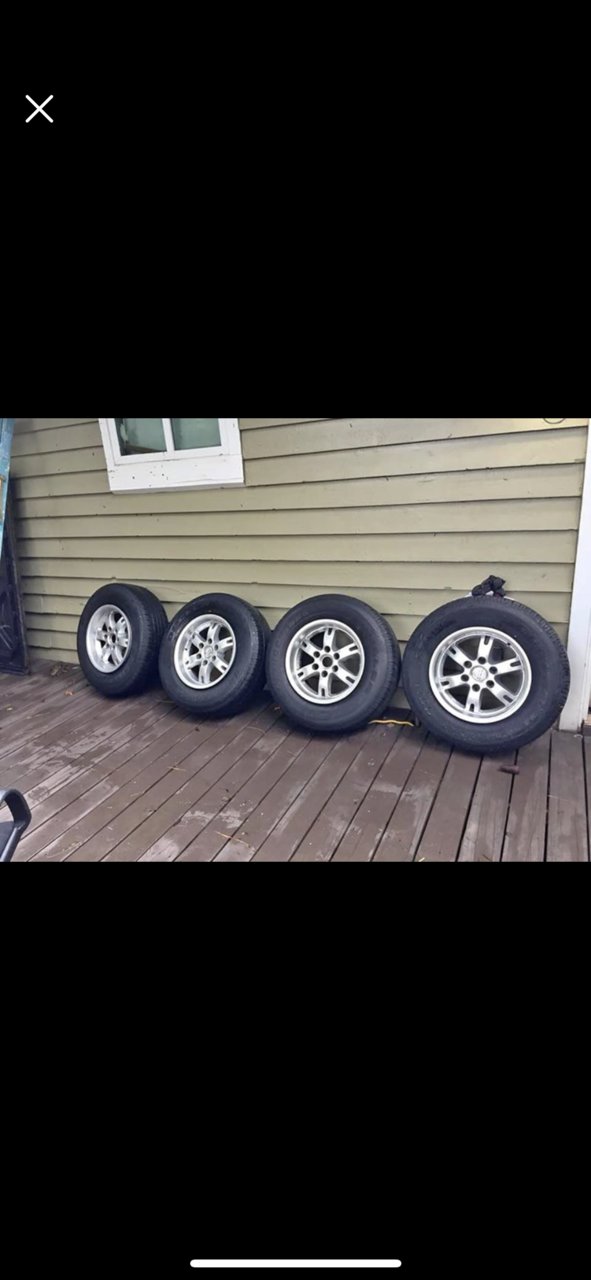

    Sorry if this question has been asked before but I can’t seem to find the answer when I searched the forum. Will 17” bbs fj cruiser wheels fit my 2017 double cab trd OR Tacoma with stock suspension? I believe the specs on the wheels are 17” x 8” with 4.76 backspacing +5mm offset. Also what are those wheels worth?

    They will fit,no more than $600

    Thanks, I was thinking about offering $400. Will they stick out a little more than my stock wheels?

    Any chance someone has pics of this setup.

    Looks like the ones @Hardscrabble has
    His are on a gen 2 though. I think they will fit no problem

    Stock backspacing is like +30 so these should stick out more

    Yes indeed, these will fit a 2nd Gen, and I’d say a 3rd Gen as well.
