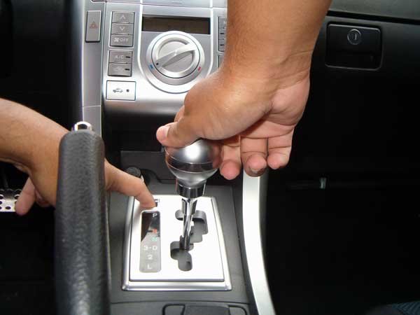

    Update: my neighbor boated in today and said the water line was at my front drivers side door handle. Quick question, I already talked to ins company and they said I can roll it out of the way of my garage door if I want to. If I turn the key to the on position (not starting it) and nothing happens electronic will I be able to put it in nutral to push it

    If not there will be a neutral shift release somewhere near the shifter. Look for a small cover usually about .75"x.25". Pop the cover off, stick your key in there and shift to neutral. I have a MT or id go look for it. Sorry to hear nick, glad you are safe and hope insurance totals your vehicle and takes care of you. Promise you dont want to deal with a flood vehicle's ghost issues.
    Edit:not a 16 tacoma, but gives you an idea what to look for04shifttoneutral.jpg

    Avoid energizing the system, use the shift lock like @brich999 pointed out
