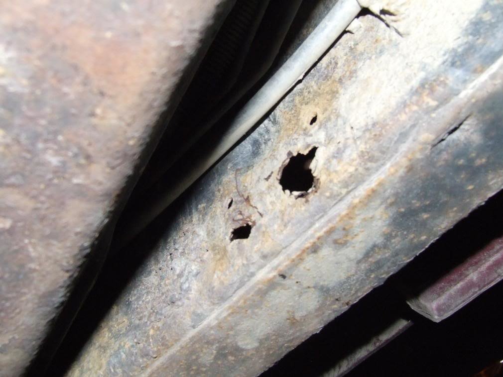

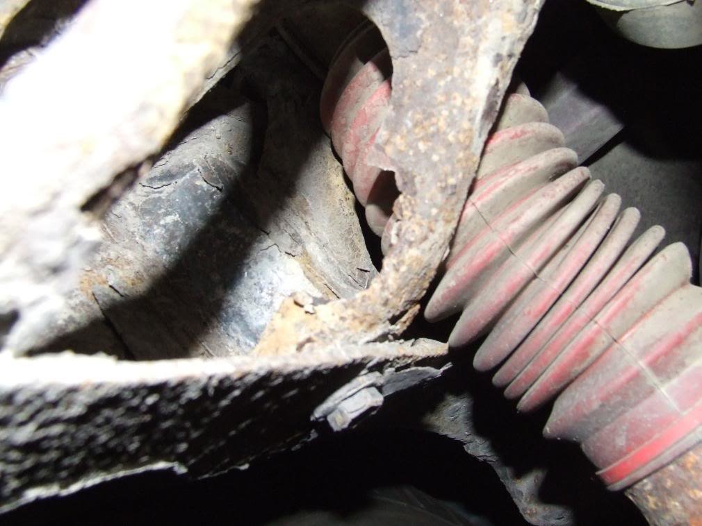

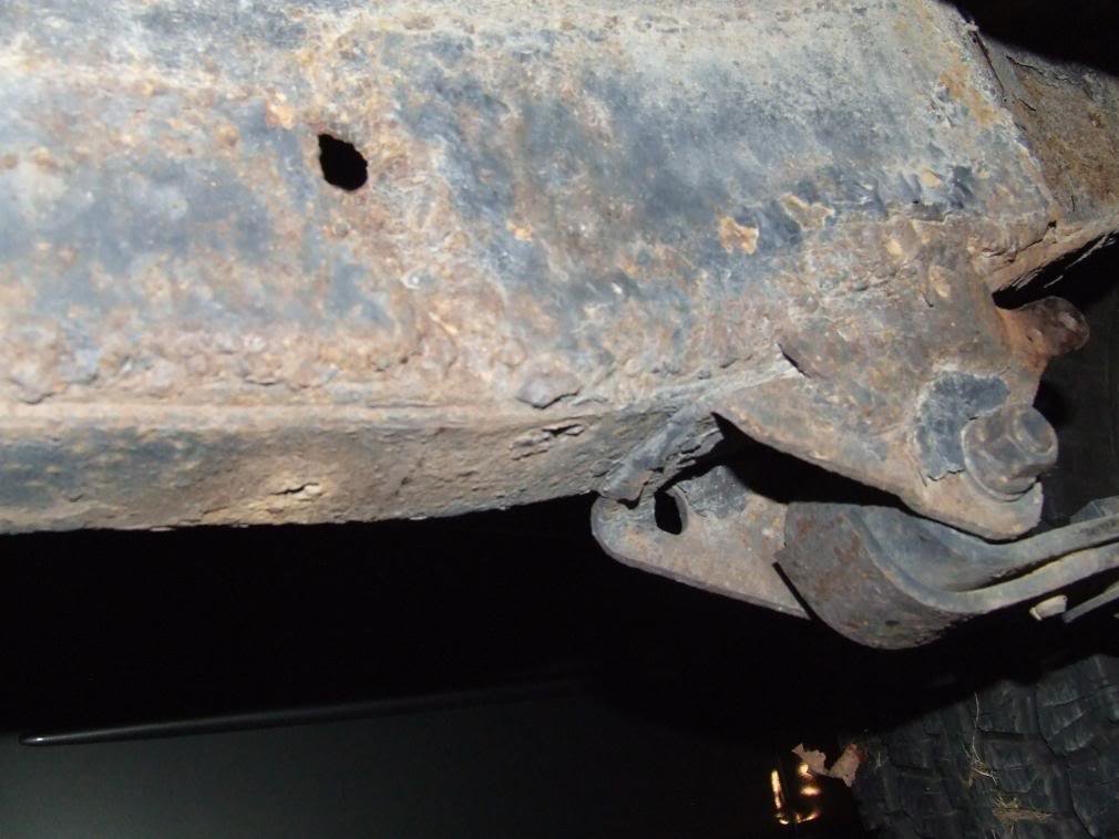

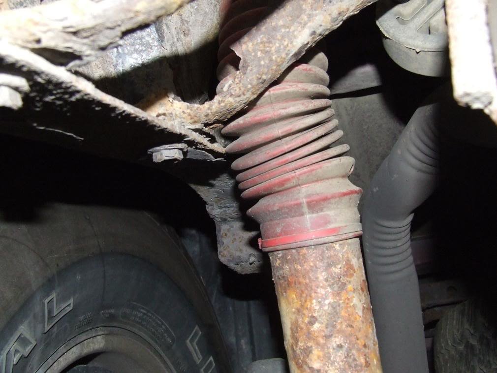

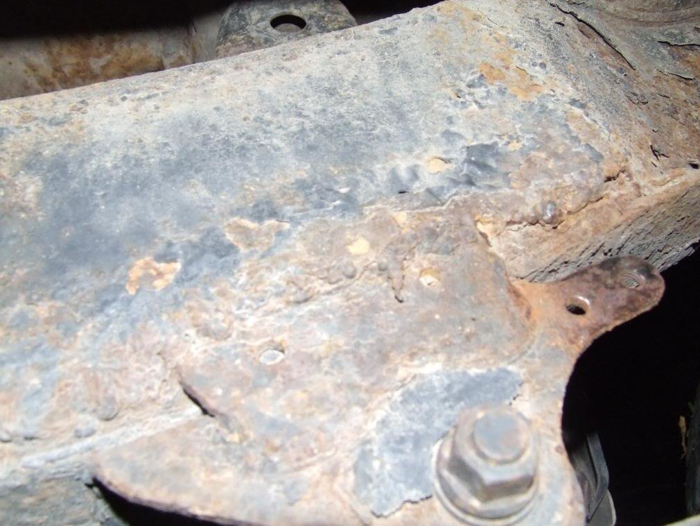

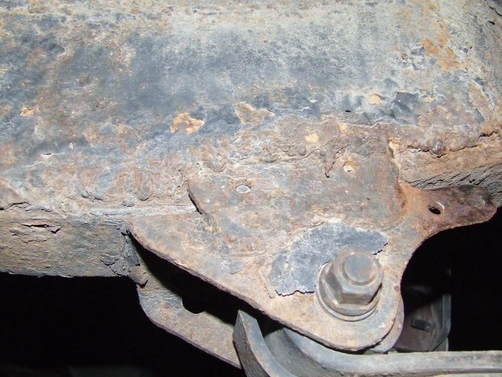

    i just got a 98 tacoma with 85k miles 5-speed. i live in upstate ny. i just found out about the recall. i didnt even title the car yet. im trying to find out if this will pass the recall?
    only the left side seems bad

    holy crap, that better!

    Pass with easy where i go.... as long as there are'nt any holes

    i've been told it is hit with a hammer and if it penetrate it fails. it doesnt necessarily need holes in it to fail. i dont want to bring it there till its titled. i thought it was pretty bad

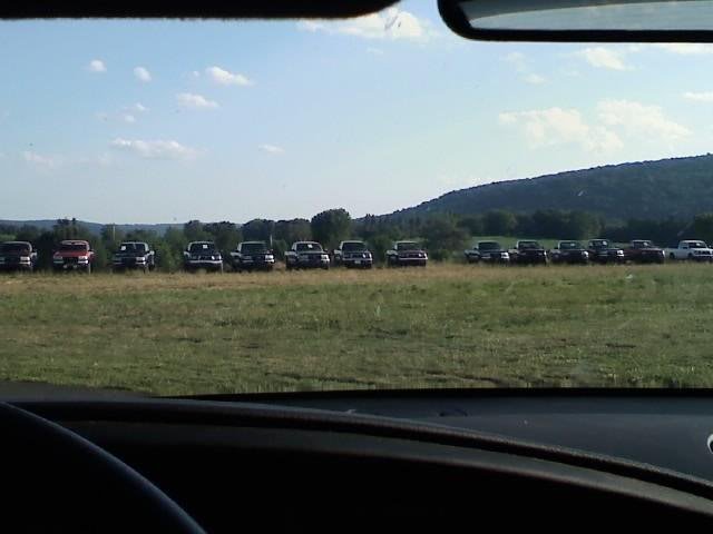

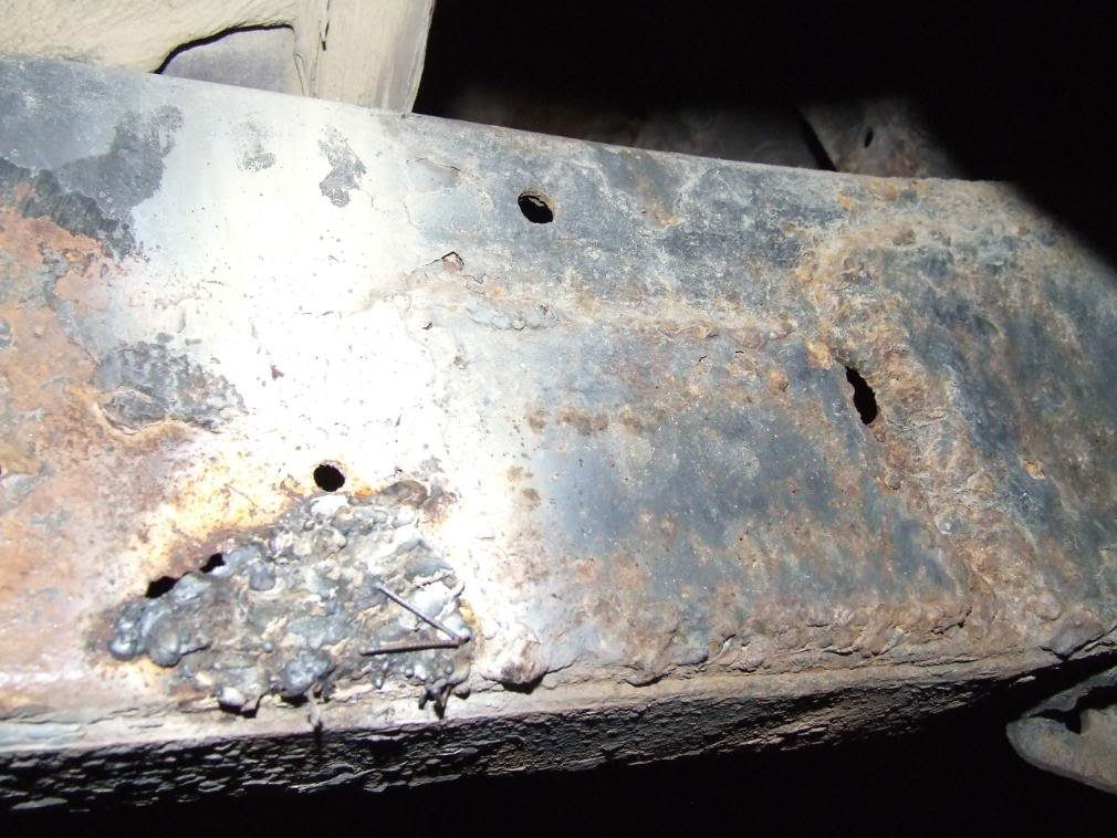

    This was a 98 xtra cab TRD OR
    There were 19 of them in the feild to be crushed when I turned mine in.

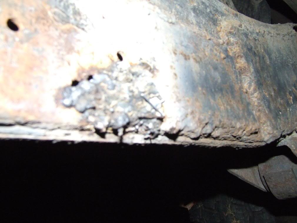

    Most of my holes had been covered/scabbed for the two years prior to the buyback.
    Yes, if the frame can be easily penetrated it will fail. If it had frame repair, it will fail. Also, check the crossmembers over the spare tire carrier.

    They do a hammer test on it and if the hammer punches a hole in the frame the inspection is failed and Toyota will buyback the truck for 150% of Kelly Blue Book. For what it's worth the frames were made for Toyota by Dana

    That's a sad photo. :( Poor Taco's.

    That's a sad photo. :( Poor Taco's.[/quote]
    Yep. :pout: That pics is a little over a year old.

    ^^^ 19 perfect woods trucks gone forever....

    What do they do? Hand you a check and you're on your way?

    Goes to toyota corperate takes like 4 weeks to get the check..... you get a rental in the meantime

    all those Tacos look bad ass too :(

    That was at the Dealership in Pennsdale by the mall
    They never offered a rental to me.
    Alot of them still had aftermarket stuff left on them too.
