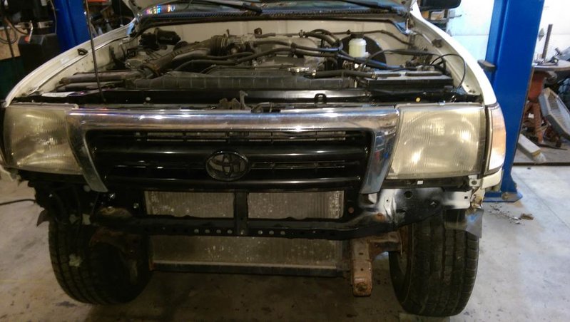

    Does your truck have these little wing things welded to the outside of the front of the frame? Should be 2 holes that bolts got threw to mount bumper. The pic of that brush guard show this is where you mount the brush guard.
    The pic shows the difference in length of frames. this truck had the frame horn from a '98 welded on to the end of the frame. It got cut off to match the length of the left side, which is the length of an '04. You can see the little wing things I was talking about.
    My '98 has the little wing things as well as my '04. They are located in the exact same position. If I'm not mistaken, the '95.5's frames are the same as the '98's. The frame horns were shortened in '01, but those wing things were left in the same location in relation to the frames.
    I'm 95% sure that guard will fit.
