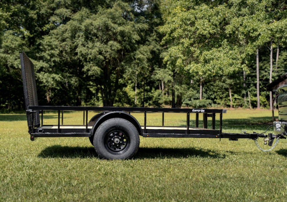

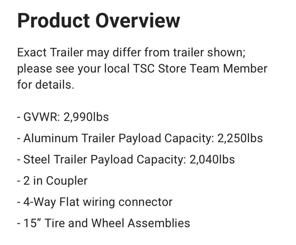

    Might be getting a Kawasaki mule from family member- 20 years or older, 4x4, 2 seater. Unsure exact model or weight. Will this trailer hold safety and tow the mule with a 4 cyl auto tacoma 3rd gen SR.. 200 miles. Florida. Mostly flat ground. Will that be too much stress on the truck?

    #457179
    87

    Look up what the Mule weighs. If it less than 2000 pounds, you will be fine.
    Be sure to have some tongue weight.

    You're asking if a trailer with unknown dimensions will carry an unknown weight and size UTV? Or are you asking if the truck will tow that combo? You might need a little more info before asking the internet the first question. But yes, the truck can tow a utility trailer with a small UTV on it.

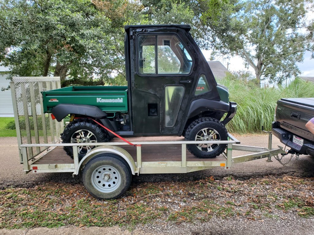

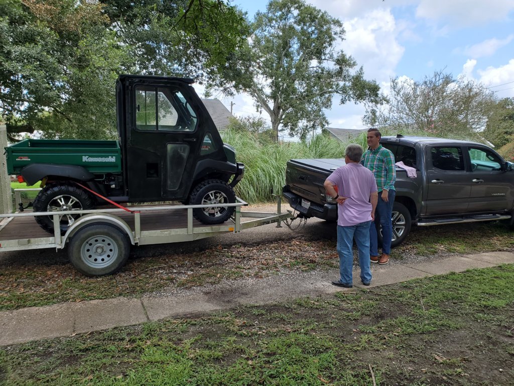

    These are pictures from when we picked up my 2009 Mule about a year and a half ago. Ours is a 4010 model which is a little bigger and heavier than some. Plus we have windshield and it had doors on it when we drove it home. I've taken the doors off since then. I think my Mule is more like about 1500 or 1600 lb, but I'd have to look to know for sure. My 3rd gen has a V6 and automatic. The trailer belongs to my sister and it is also aluminum like the one that you attached a picture of. The drive home with it was close to 200 miles.
    Edit: The 4010 is 1431 pounds, plus mine has doors, front glass, roof, and back glass. Plus a horse mat in the cargo bed that weighs a ton. I took the doors off, and added gas struts to aid in opening the engine compartment (with that heavy horse mat). It's 62" wide, and 118" long.
